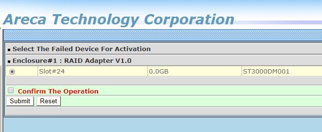

do you believe its a physical disconnect? i wonder if thats because the Areca failed it. (see attached) it wont let me activate the drive.

I only wanted the new diagnostics so I could see SMART for that disk. You will have to rebuild disk2 anyway. Do you have a spare disk you could try?

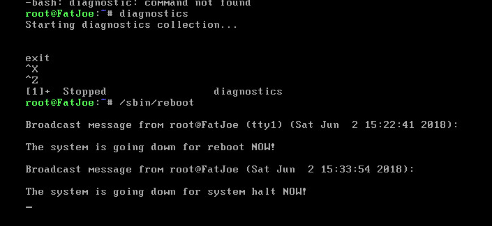

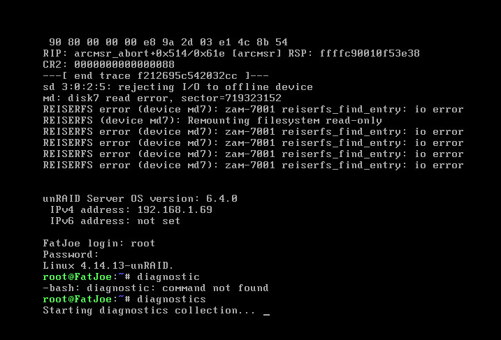

so i kicked off a parity check and this morning two more drives went into error state. now it seems like the array is locked up.. i can browse the various tabs in the UI but cant get to any data. it wont even run a diagnostics.
i'm afraid to reboot but i may have to
its locked up real good cant shutdown or reboot from the cli or gui

ok got the array up but it's still showing the two drives as "disabled"
they when disabled during a parity check not writing to them  the following in the SMART info for the drives

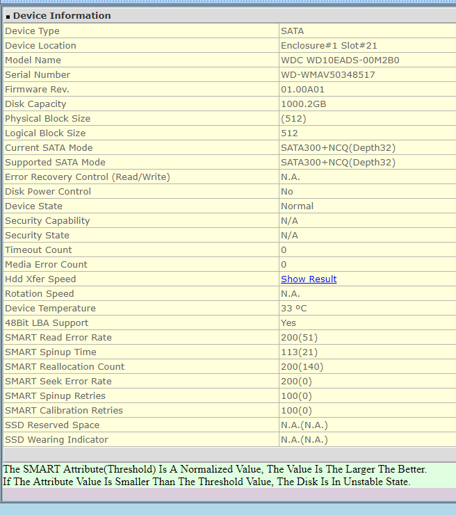

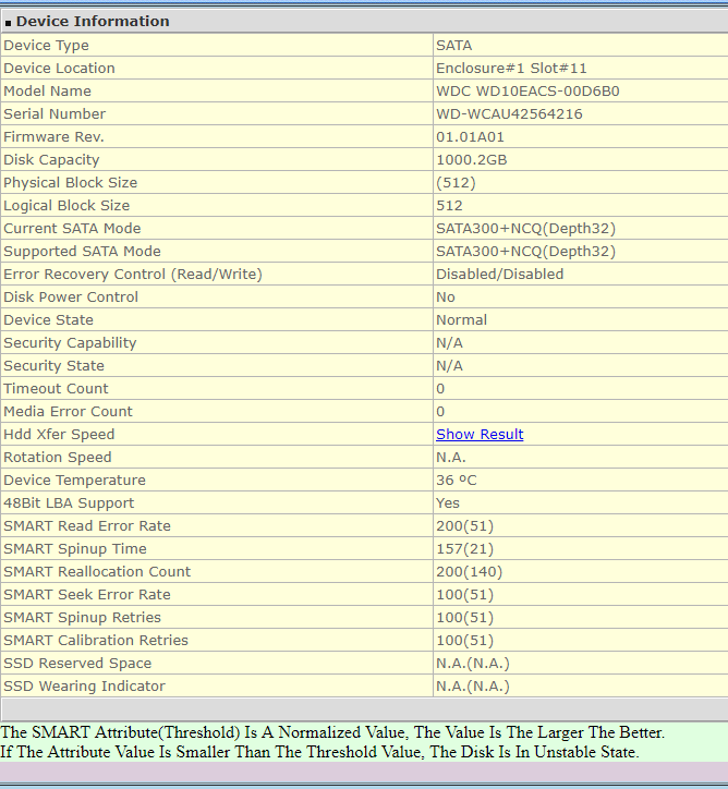

4 hours ago, ToXIc said:
should i look at getting a new drive or is there a way to get these back online ?
Difficult to say since the controller you're using doesn't pass SMART info, see if you can get SMART reports from all disks.
