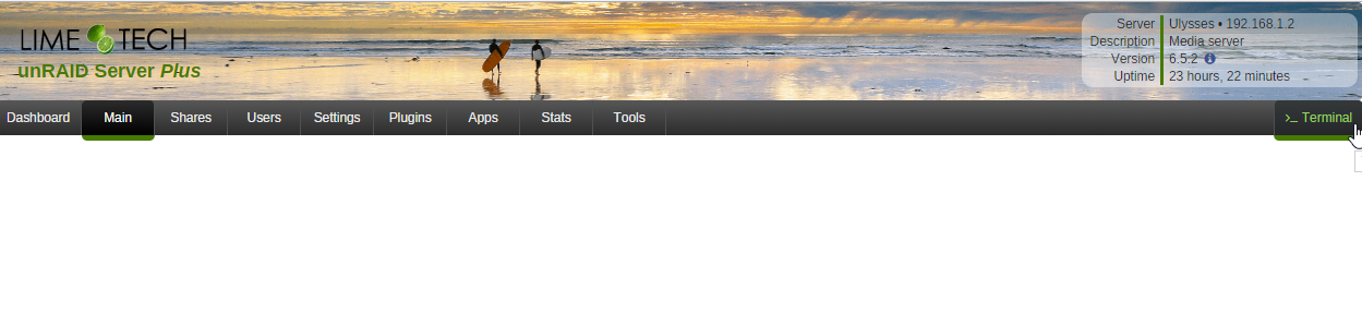

June 8, 20188 yr Does look the same as this before hand? Because this is what mine is doing.... Doesn't matter what tab you click on, nothing loads. I can access terminal though.
June 8, 20188 yr Community Expert 5 hours ago, taxydrivar said: Does look the same as this before hand? Because this is what mine is doing.... Doesn't matter what tab you click on, nothing loads. I can access terminal though. If you have an ad blocker whitelist your server.
