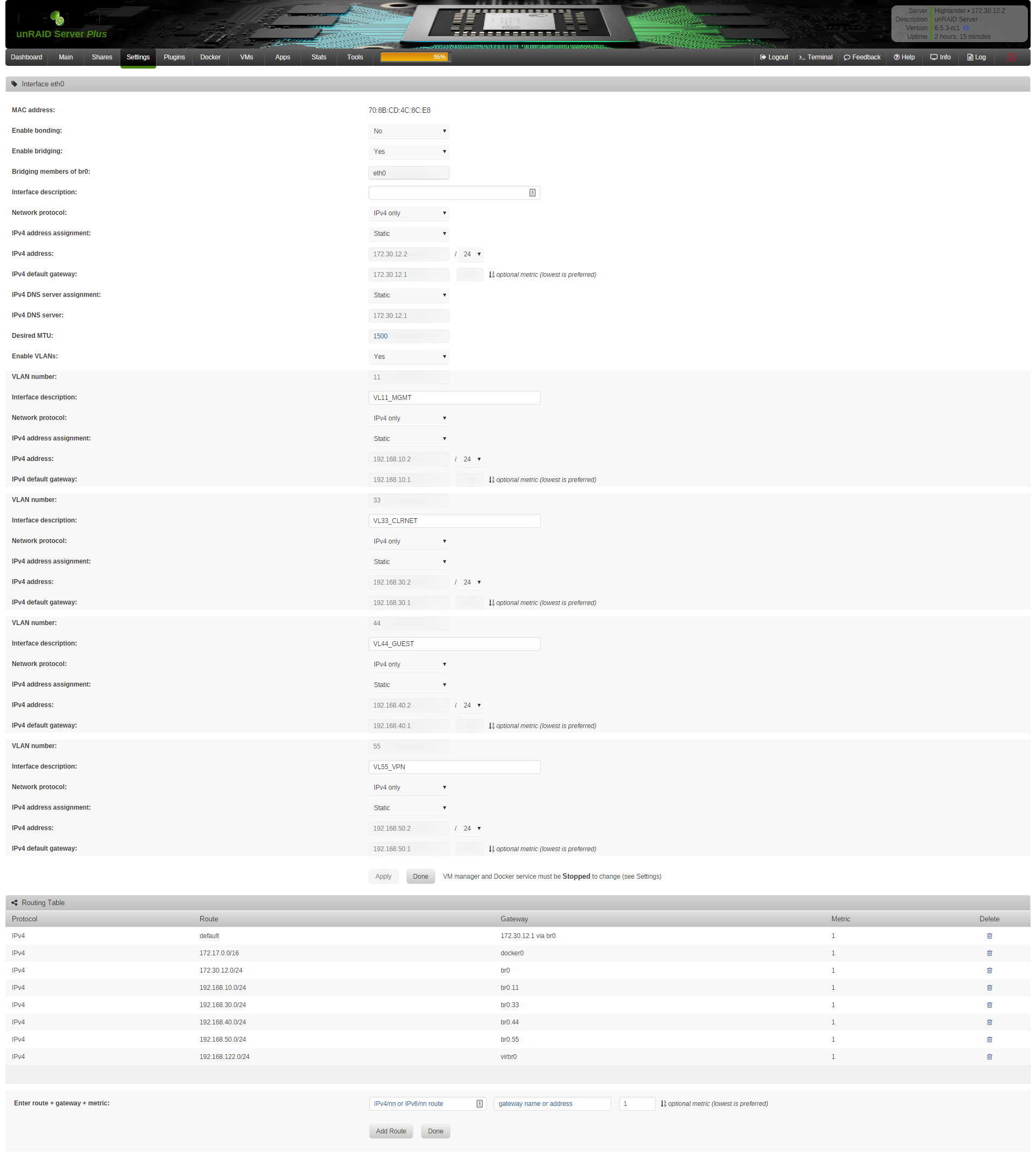

Anything jump out as wrong in my settings?  I had the VM on br0 for the test and not a VLAN (pfsense VM wasn't even fired up) with my WAN going straight into my unRAID nic to try and eliminate problems.
1594275793_FireShotCapture118-Highlander_NetworkSettings_-https___1d087a25aac48109ee9a15217a.thumb.png.2fdab0963913085001b1c9002247482b.png
Looks good to me, but I don't use VLANs, don't know if that can make a difference.
