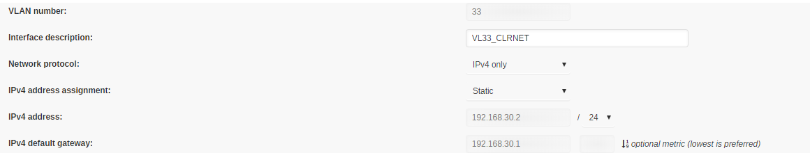

1 hour ago, ken-ji said:
Make sure that if you do put plex docker on a VLAN (ie br0.1|eth0.1), make sure that there is no assigned IP to that interface for unRAID.
Just re-read this.  My plex docker is on br0.33 - are you saying I shouldn't have filled in 192.168.30.2 here for the IPV4 address?309001390_FireShotCapture119-Highlander_NetworkSettings_-https___1d087a25aac48109ee9a15217a.thumb.png.c395b68fb1002e21d087d6d1392d18c6.png
Edited by DZMM
Yep. you need to keep it empty. See my setup linked above.
Technical explanation why it doesn't work:
if there is an ip assigned to the VLAN interface, unRAID will use that to talk to the docker network as it is a directly attached network (check the routing table). which will fail because it is a macvlan subinterface of the VLAN interface. Same issue with br0 and docker network on that interface
if there is no ip assigned to the VLAN interface, unRAID will now need to use the router to talk to docker network. which now works as it is a valid external communication, same as how the internet can talk back to your docker container.
traceroute will give you a better idea of what's wrong.
Edited by ken-ji
Ahh, I just assumed when setting up VLANs you had to create an address for unRAID.  Will fix, once I doublecheck I'm not referencing the old VLAN unRAID IP addresses anywhere.
Thanks
All sorted now - thanks
