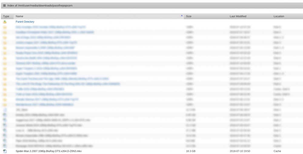

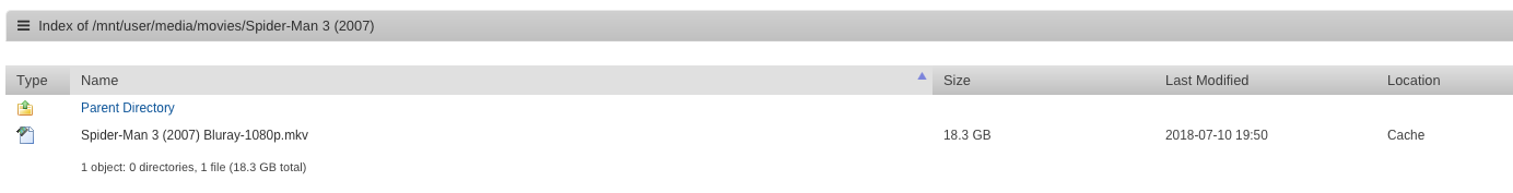

July 11, 20188 yr Hey, I have a new build and am desperately trying to set up reliable hard linking with radarr & deluge. I've hit a wall, see below • Radar and deluge have access to the same share containing both the download folder & the movie folder, eg: Radarr host path: /media : /mnt/user/media/ Radarr movie root folder: /media/movies/ Deluge host path: /media : /mnt/user/media/ Deluge move complete downloads: /media/downloads/passthepopcorn/ • Radarr is set up to hard link the files to the movie root (/media/movies/). • In the case of a test file I added to Radarr, "Spider Man 3" the shares folder indicates both the download file and Radarrs supposedly hard linked version both reside on the same disk, in this case the cache drive (see attached screenshots). This is where I'm stuck; • When checking the Inode of the two files, both indicate they are linked twice, but they have different Inodes?! The downloaded file: root@server:/mnt/user/media/downloads/passthepopcorn# stat Spider-Man.3.2007.1080p.BluRay.DTS.x264.D-Z0N3.mkv | grep Inode Device: 21h/33d Inode: 10645 Links: 2 Radarrs movie foot file: root@server:/mnt/user/media/movies/Spider-Man 3 (2007)# stat Spider-Man\ 3\ \(2007\)\ Bluray-1080p.mkv | grep Inode Device: 21h/33d Inode: 15657 Links: 2 Can someone shed some light on this please? As a followup query, if the mover moves the files off the cache drive, will that break the hard links (assuming they worked in the first place)? server-diagnostics-20180711-1158.zip
