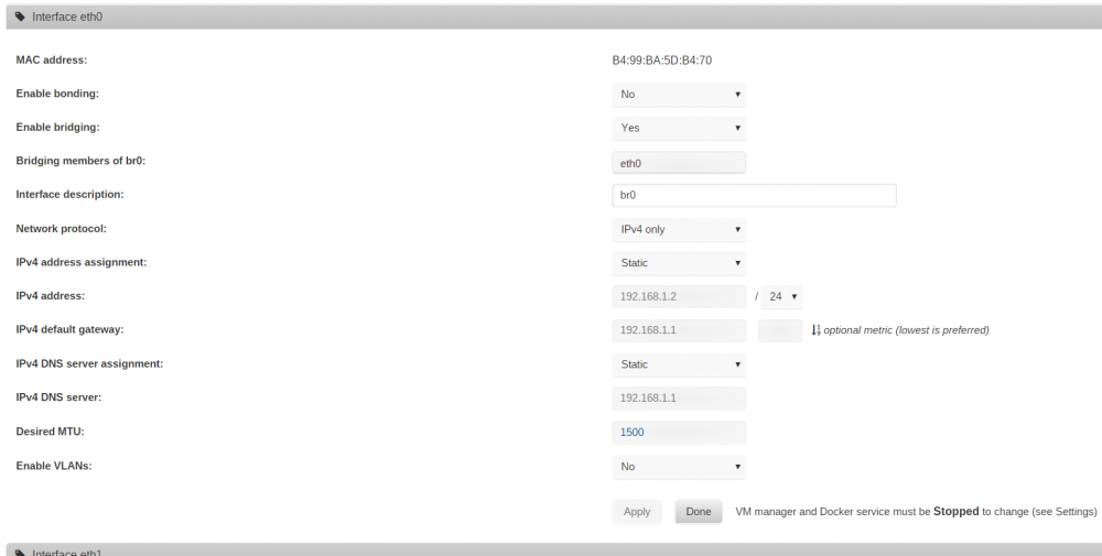

July 11, 20188 yr hi, may a question if something like this is "easy" possible in my example tvheadend docker would need more then 1 ip address to get more satip streams from my fritz 6490 (buildin 4 cable tuner, only 1 stream per ip) tvheadend docker running in host mode (not a sep. ip cause setup ip´s for dockers and then how to route them so they can talk to host each other is over my head ...) fritz is my modem, running 192.168.178.1 -> only connected to -> router behind is a netgear r9000 (also the DHCP, Wifi, ...) running 192.168.1.1 from here my network starts. like unraid on 192.168.1.2 i aleady setup tvheadend so it sees and can use the fritz dvb-c tuner (1 stream only), so that is looking good, now, as the fritz 6490 only allows 1 stream each i would need to assign different ips to each tuner, therefore my TVH docker would need more ip´s so, is that "easy" possible, on linux i assume i would assign them in /etc/network/interfaces, but here ... also without loosing the host mode ... im using nginx, plex, tvhproxy etc etc ... wich are all used together, so starting with sep. ip´s would probably need to route all them together, and when i tryed that when it was introduced in 6.4 i guess i got lost all over and reverted back thanks ahead for an tipp

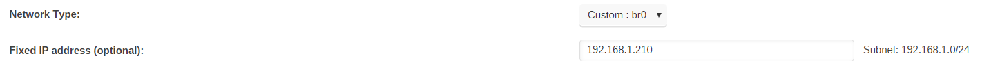

July 11, 20188 yr Author well, may a hint where to look for, i can assign a ip address and that works out of the box, where would i know add this command docker network connect [OPTIONS] NETWORK CONTAINER so my docker tvheadend could communicate with the host again my network config is like next step then would be, how to add more interfaces inside the docker cause when i assign an ip i dont see /etc/network/interfaces also i dont see a option to add more ip´s from unraid UI. thanks again for an hint.

July 11, 20188 yr Author when i set an ip in tvheadend docker settings then i do root@AlsServer:~# docker network connect bridge tvheadend still cant ping ... so no access from host root@AlsServer:~# docker exec -ti tvheadend bash root@f79300b7868c:/$ route -n Kernel IP routing table Destination Gateway Genmask Flags Metric Ref Use Iface 0.0.0.0 192.168.1.1 0.0.0.0 UG 0 0 0 eth0 172.17.0.0 0.0.0.0 255.255.0.0 U 0 0 0 eth1 192.168.1.0 0.0.0.0 255.255.255.0 U 0 0 0 eth0 root@f79300b7868c:/$ exit exit root@AlsServer:~# ping 192.168.1.210 PING 192.168.1.210 (192.168.1.210) 56(84) bytes of data. From 192.168.1.2 icmp_seq=1 Destination Host Unreachable From 192.168.1.2 icmp_seq=2 Destination Host Unreachable From 192.168.1.2 icmp_seq=3 Destination Host Unreachable ... im pretty sure the command has to specified better ? thats my tvheadend ip setup thanks ahead

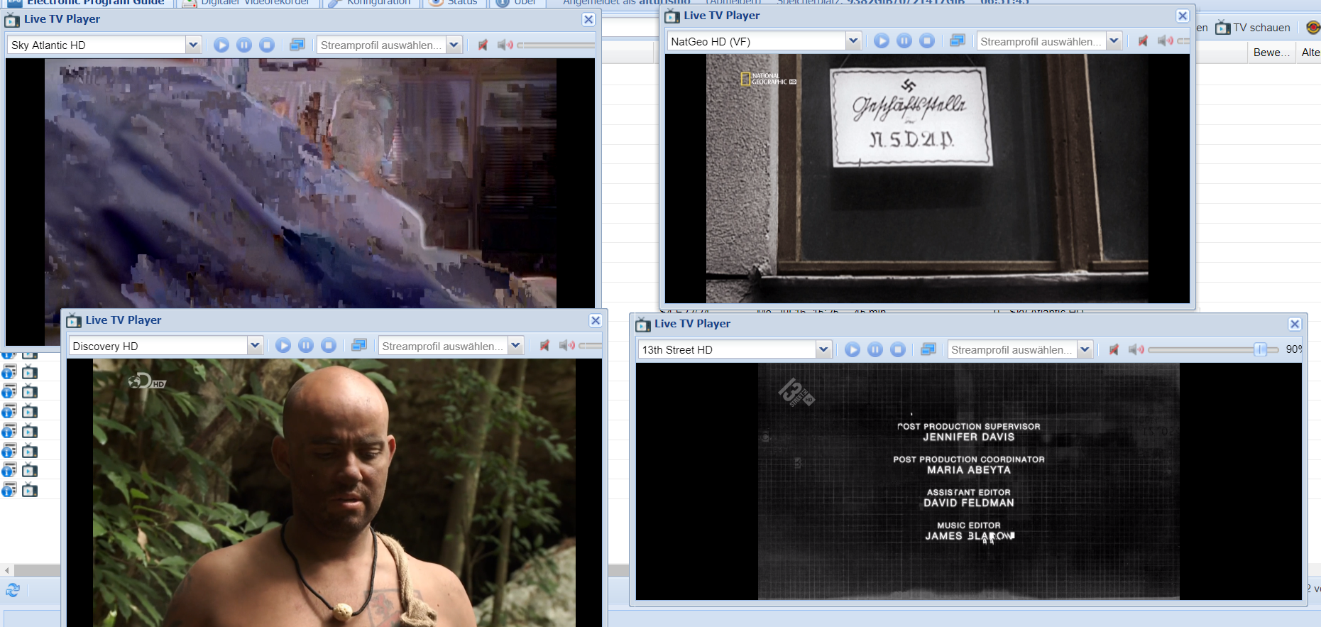

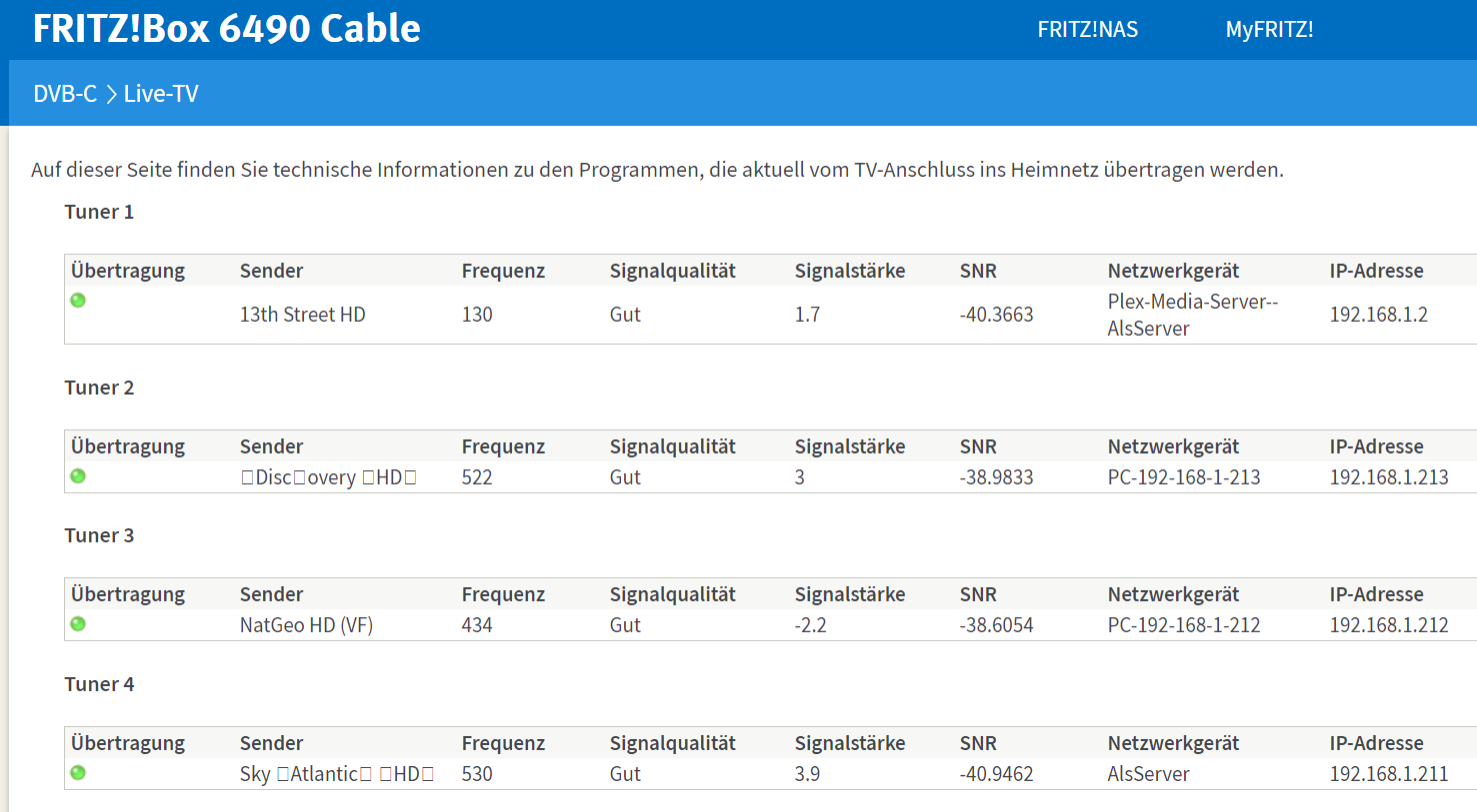

July 14, 20188 yr Author ok, seems i have my 4 ips now with host mode active funny, nvm. tomorrow i have to reconfig my routers cause i saw now im double NAT ... i use the FRITZ only as modem, but if i want to use the TV tuners now ... my 2nd router is always the receiving client, so my 4 ips are still useless and as i have no idea how to pass the ip to the router outside ... lets see if i find time tomorrow, i ll report if it worked out.
July 15, 20188 yr Author ok, changed my 2nd Router to AP mode, and TVHeadend worked now with its ip addresses so, thanks for the tipp with pipework. what i did was, i started TVHeadend with the pipework trigger AND in host mode, for each several ip i added -e 'pipework_cmd=br0 -i eth4 @CONTAINER_NAME@ 192.168.1.211/[email protected]' -e 'pipework_cmd=br0 -i eth5 @CONTAINER_NAME@ 192.168.1.212/[email protected]' -e 'pipework_cmd=br0 -i eth6 @CONTAINER_NAME@ 192.168.1.213/[email protected]' so now, TVH listening here on 192.168.1.2 (host), 192.168.1.211 ..212 ...213 (extra interfaces), no issue with other dockers cause Host is active and extra ip´s are here ... now, TVHeadend has its ip´s and even kept them after docker update, also when i start TVHeadend now without any pipework command the ip´s keep active ... sadly something messed up generally with changing the router setups, couldnt resolve my IPv4 externally anymore, so i had to revert back now to my double nat setup, other story to fix. my ipaddr in TVH looks now root@AlsServer:~# docker exec -ti tvheadend bash root@AlsServer:/$ ipaddr 1: lo: <LOOPBACK,UP,LOWER_UP> mtu 65536 qdisc noqueue state UNKNOWN qlen 1000 link/loopback 00:00:00:00:00:00 brd 00:00:00:00:00:00 inet 127.0.0.1/8 scope host lo valid_lft forever preferred_lft forever inet6 ::1/128 scope host valid_lft forever preferred_lft forever 2: tunl0@NONE: <NOARP> mtu 1480 qdisc noop state DOWN qlen 1000 link/ipip 0.0.0.0 brd 0.0.0.0 3: gre0@NONE: <NOARP> mtu 1476 qdisc noop state DOWN qlen 1000 link/gre 0.0.0.0 brd 0.0.0.0 4: gretap0@NONE: <BROADCAST,MULTICAST> mtu 1462 qdisc noop state DOWN qlen 1000 link/ether 00:00:00:00:00:00 brd ff:ff:ff:ff:ff:ff 5: erspan0@NONE: <BROADCAST,MULTICAST> mtu 1450 qdisc noop state DOWN qlen 1000 link/ether 00:00:00:00:00:00 brd ff:ff:ff:ff:ff:ff 6: ip_vti0@NONE: <NOARP> mtu 1480 qdisc noop state DOWN qlen 1000 link/ipip 0.0.0.0 brd 0.0.0.0 7: sit0@NONE: <NOARP> mtu 1480 qdisc noop state DOWN qlen 1000 link/sit 0.0.0.0 brd 0.0.0.0 10: eth0: <BROADCAST,MULTICAST,UP,LOWER_UP100> mtu 1500 qdisc mq master br0 state UP qlen 1000 link/ether b4:99:ba:5d:b4:70 brd ff:ff:ff:ff:ff:ff inet6 fe80::b699:baff:fe5d:b470/64 scope link valid_lft forever preferred_lft forever 11: eth1: <NO-CARRIER,BROADCAST,MULTICAST,UP100> mtu 1500 qdisc mq master br1 state DOWN qlen 1000 link/ether b4:99:ba:5d:b4:74 brd ff:ff:ff:ff:ff:ff 12: br0: <BROADCAST,MULTICAST,UP,LOWER_UP> mtu 1500 qdisc noqueue state UP qlen 1000 link/ether 12:13:41:c1:45:73 brd ff:ff:ff:ff:ff:ff inet 192.168.1.2/24 scope global br0 valid_lft forever preferred_lft forever inet6 fe80::8c19:40ff:fe1a:969f/64 scope link valid_lft forever preferred_lft forever 13: br1: <NO-CARRIER,BROADCAST,MULTICAST,UP> mtu 1500 qdisc noqueue state DOWN qlen 1000 link/ether b4:99:ba:5d:b4:74 brd ff:ff:ff:ff:ff:ff inet 192.168.1.2/24 scope global br1 valid_lft forever preferred_lft forever inet6 fe80::6441:91ff:fe56:2b3f/64 scope link valid_lft forever preferred_lft forever 14: docker0: <BROADCAST,MULTICAST,UP,LOWER_UP> mtu 1500 qdisc noqueue state UP link/ether 02:42:14:7c:b9:99 brd ff:ff:ff:ff:ff:ff inet 172.17.0.1/16 scope global docker0 valid_lft forever preferred_lft forever inet6 fe80::42:14ff:fe7c:b999/64 scope link valid_lft forever preferred_lft forever 16: veth0b2605c@if15: <BROADCAST,MULTICAST,UP,LOWER_UP,M-DOWN> mtu 1500 qdisc noqueue master docker0 state UP link/ether 62:fb:64:a4:d0:27 brd ff:ff:ff:ff:ff:ff inet6 fe80::60fb:64ff:fea4:d027/64 scope link valid_lft forever preferred_lft forever 18: veth6f3e79b@if17: <BROADCAST,MULTICAST,UP,LOWER_UP,M-DOWN> mtu 1500 qdisc noqueue master docker0 state UP link/ether 06:4a:ee:a9:03:f8 brd ff:ff:ff:ff:ff:ff inet6 fe80::44a:eeff:fea9:3f8/64 scope link valid_lft forever preferred_lft forever 20: vethd612b77@if19: <BROADCAST,MULTICAST,UP,LOWER_UP,M-DOWN> mtu 1500 qdisc noqueue master docker0 state UP link/ether a6:9a:ab:0d:ad:87 brd ff:ff:ff:ff:ff:ff inet6 fe80::a49a:abff:fe0d:ad87/64 scope link valid_lft forever preferred_lft forever 22: veth6626e7d@if21: <BROADCAST,MULTICAST,UP,LOWER_UP,M-DOWN> mtu 1500 qdisc noqueue master docker0 state UP link/ether e6:51:21:0e:f5:12 brd ff:ff:ff:ff:ff:ff inet6 fe80::e451:21ff:fe0e:f512/64 scope link valid_lft forever preferred_lft forever 24: vethf9270a8@if23: <BROADCAST,MULTICAST,UP,LOWER_UP,M-DOWN> mtu 1500 qdisc noqueue master docker0 state UP link/ether 8a:58:75:de:4e:a4 brd ff:ff:ff:ff:ff:ff inet6 fe80::8858:75ff:fede:4ea4/64 scope link valid_lft forever preferred_lft forever 26: vethb3fbfb0@if25: <BROADCAST,MULTICAST,UP,LOWER_UP,M-DOWN> mtu 1500 qdisc noqueue master docker0 state UP link/ether fe:c4:c3:40:5a:6d brd ff:ff:ff:ff:ff:ff inet6 fe80::fcc4:c3ff:fe40:5a6d/64 scope link valid_lft forever preferred_lft forever 28: veth72f610d@if27: <BROADCAST,MULTICAST,UP,LOWER_UP,M-DOWN> mtu 1500 qdisc noqueue master docker0 state UP link/ether 7a:f7:cb:4c:c2:f8 brd ff:ff:ff:ff:ff:ff inet6 fe80::78f7:cbff:fe4c:c2f8/64 scope link valid_lft forever preferred_lft forever 30: veth68a9cf6@if29: <BROADCAST,MULTICAST,UP,LOWER_UP,M-DOWN> mtu 1500 qdisc noqueue master docker0 state UP link/ether 0e:67:d0:1e:20:de brd ff:ff:ff:ff:ff:ff inet6 fe80::c67:d0ff:fe1e:20de/64 scope link valid_lft forever preferred_lft forever 32: veth58a9f7b@if31: <BROADCAST,MULTICAST,UP,LOWER_UP,M-DOWN> mtu 1500 qdisc noqueue master docker0 state UP link/ether 02:70:79:4c:53:cc brd ff:ff:ff:ff:ff:ff inet6 fe80::70:79ff:fe4c:53cc/64 scope link valid_lft forever preferred_lft forever 34: veth1d11dd9@if33: <BROADCAST,MULTICAST,UP,LOWER_UP,M-DOWN> mtu 1500 qdisc noqueue master docker0 state UP link/ether a6:22:eb:08:c6:f1 brd ff:ff:ff:ff:ff:ff inet6 fe80::a422:ebff:fe08:c6f1/64 scope link valid_lft forever preferred_lft forever 36: veth19c0fe2@if35: <BROADCAST,MULTICAST,UP,LOWER_UP,M-DOWN> mtu 1500 qdisc noqueue master docker0 state UP link/ether ae:0b:3c:f5:b1:f1 brd ff:ff:ff:ff:ff:ff inet6 fe80::ac0b:3cff:fef5:b1f1/64 scope link valid_lft forever preferred_lft forever 37: virbr0: <NO-CARRIER,BROADCAST,MULTICAST,UP> mtu 1500 qdisc noqueue state DOWN qlen 1000 link/ether 52:54:00:9b:87:26 brd ff:ff:ff:ff:ff:ff inet 192.168.122.1/24 brd 192.168.122.255 scope global virbr0 valid_lft forever preferred_lft forever 38: virbr0-nic: <BROADCAST,MULTICAST> mtu 1500 qdisc pfifo_fast master virbr0 state DOWN qlen 1000 link/ether 52:54:00:9b:87:26 brd ff:ff:ff:ff:ff:ff 39: vnet0: <BROADCAST,MULTICAST,UP,LOWER_UP> mtu 1500 qdisc pfifo_fast master br0 state UNKNOWN qlen 1000 link/ether fe:54:00:74:f7:ef brd ff:ff:ff:ff:ff:ff inet6 fe80::fc54:ff:fe74:f7ef/64 scope link valid_lft forever preferred_lft forever 40: eth6@veth6pl32569: <BROADCAST,MULTICAST,UP,LOWER_UP> mtu 1500 qdisc noqueue state UP qlen 1000 link/ether 82:c8:48:2c:2f:e2 brd ff:ff:ff:ff:ff:ff inet 192.168.1.213/24 scope global eth6 valid_lft forever preferred_lft forever inet6 fe80::80c8:48ff:fe2c:2fe2/64 scope link valid_lft forever preferred_lft forever 41: veth6pl32569@eth6: <BROADCAST,MULTICAST,UP,LOWER_UP> mtu 1500 qdisc noqueue master br0 state UP qlen 1000 link/ether 96:b5:e5:c6:97:d1 brd ff:ff:ff:ff:ff:ff inet6 fe80::94b5:e5ff:fec6:97d1/64 scope link valid_lft forever preferred_lft forever 42: veth6pg1146@veth6pl1146: <BROADCAST,MULTICAST> mtu 1500 qdisc noop state DOWN qlen 1000 link/ether e6:34:85:7c:8f:6e brd ff:ff:ff:ff:ff:ff 43: veth6pl1146@veth6pg1146: <NO-CARRIER,BROADCAST,MULTICAST,UP,M-DOWN> mtu 1500 qdisc noqueue master br0 state LOWERLAYERDOWN qlen 1000 link/ether 12:13:41:c1:45:73 brd ff:ff:ff:ff:ff:ff 44: veth6pg2080@veth6pl2080: <BROADCAST,MULTICAST> mtu 1500 qdisc noop state DOWN qlen 1000 link/ether ee:61:8b:31:95:fb brd ff:ff:ff:ff:ff:ff 45: veth6pl2080@veth6pg2080: <NO-CARRIER,BROADCAST,MULTICAST,UP,M-DOWN> mtu 1500 qdisc noqueue master br0 state LOWERLAYERDOWN qlen 1000 link/ether e2:19:d6:3e:f0:f0 brd ff:ff:ff:ff:ff:ff 46: eth5@veth5pl3302: <BROADCAST,MULTICAST,UP,LOWER_UP> mtu 1500 qdisc noqueue state UP qlen 1000 link/ether be:aa:11:87:07:4f brd ff:ff:ff:ff:ff:ff inet 192.168.1.212/24 scope global eth5 valid_lft forever preferred_lft forever inet6 fe80::bcaa:11ff:fe87:74f/64 scope link valid_lft forever preferred_lft forever 47: veth5pl3302@eth5: <BROADCAST,MULTICAST,UP,LOWER_UP> mtu 1500 qdisc noqueue master br0 state UP qlen 1000 link/ether c2:5d:27:06:92:80 brd ff:ff:ff:ff:ff:ff inet6 fe80::c05d:27ff:fe06:9280/64 scope link valid_lft forever preferred_lft forever 48: veth6pg4147@veth6pl4147: <BROADCAST,MULTICAST> mtu 1500 qdisc noop state DOWN qlen 1000 link/ether 02:a7:cf:e1:a4:50 brd ff:ff:ff:ff:ff:ff 49: veth6pl4147@veth6pg4147: <NO-CARRIER,BROADCAST,MULTICAST,UP,M-DOWN> mtu 1500 qdisc noqueue master br0 state LOWERLAYERDOWN qlen 1000 link/ether 8e:de:48:53:65:43 brd ff:ff:ff:ff:ff:ff 50: eth4@veth4pl6261: <BROADCAST,MULTICAST,UP,LOWER_UP> mtu 1500 qdisc noqueue state UP qlen 1000 link/ether fa:79:02:da:a0:0f brd ff:ff:ff:ff:ff:ff inet 192.168.1.211/24 scope global eth4 valid_lft forever preferred_lft forever inet6 fe80::f879:2ff:feda:a00f/64 scope link valid_lft forever preferred_lft forever 51: veth4pl6261@eth4: <BROADCAST,MULTICAST,UP,LOWER_UP> mtu 1500 qdisc noqueue master br0 state UP qlen 1000 link/ether 3a:8f:c9:f3:11:02 brd ff:ff:ff:ff:ff:ff inet6 fe80::388f:c9ff:fef3:1102/64 scope link valid_lft forever preferred_lft forever thanks again for the tipp with pipework, hope it didnt break anything else now , i now have to check my routers setup to get this sorted with my IP v4 addresses and so on.
