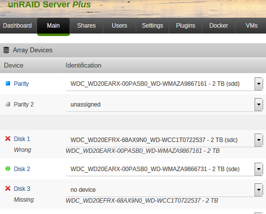

OK. I followed this advice and determined device sdd was the parity drive as it would not mount. However when I try to assign drives appropriately, unraid os says its an 'invalid configuration'. Am I taking a wrong step somewhere?
It's telling you right there:
s/n  ...161 is disk 1 (you've currently got it as parity)
s/n ...537 should be disk 3 (you've got it as disk 1)
Disk 2 you've got correct.
And, it appears that you didn't have a parity drive

Ok, @Squid apparently is having reading comprehension issues tonight.?
Assuming you followed @johnnie.black's advice correctly when you came to this conclusion
Then you need to do another new config and set the devices as needed.
Squid is telling you to put the drives back the way they were when you found the single unmountable drive. Once you assigned the drives in the test configuration, unraid remembers where they were and won't let you move them without setting a new config.
BTW, sdd is not a good way to ID the drives, always use the serial number as the sdX designation can change when the server is rebooted for various reasons.
Once you set the new config, you can assign the drives and set the checkbox that parity is already valid, then do a correcting parity check. Just be VERY sure that you selected the correct drive as parity, because it will be wiped out if you set it incorrectly.
