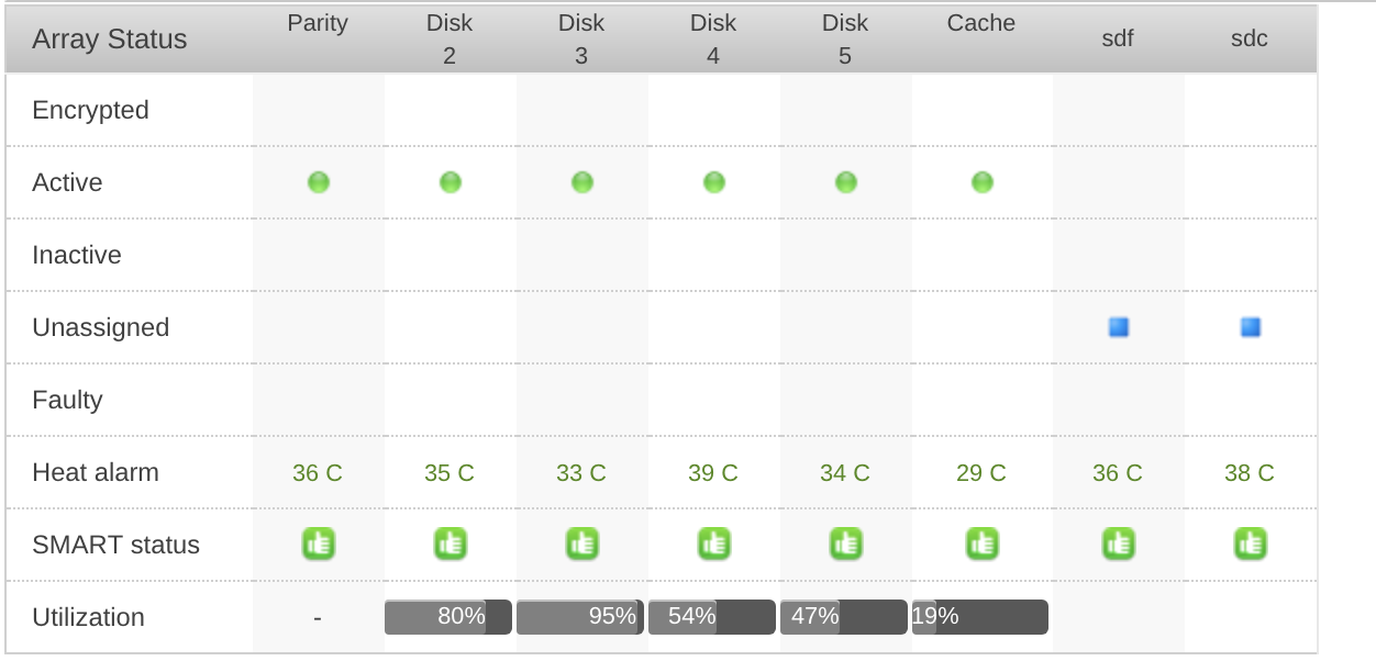

July 19, 20188 yr I rebooted and one of my hard drives was no longer showing up. When i try to pick it from the drop when re-assigning disks it keeps showing as not installed. I bought another hard drive and precleared them both, yet i am still not able to re-add the drive. It is not showing as missing just not installed. This is a 5 TB drive that i have about 3.5TB data that I really dont want to loose. Any ideas? tower2-diagnostics-20180719-1903.zip Edited July 27, 20188 yr by dertbv

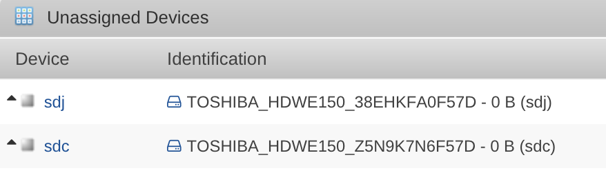

July 23, 20188 yr Author I have removed preclear plugin and rebooted. still not able to add the drives. the both are showing "0 B" on the list. Any ideals on what my next steps are? tower2-diagnostics-20180723-0223.zip Edited July 23, 20188 yr by dertbv

July 23, 20188 yr Author Here is the part that is bothering me.. I am using the same disk for most of my drives Currently in array "TOSHIBA_HDWE150_*** - 5 TB (sde)" New Disks after preclear "TOSHIBA_HDWE150_*** - 0 B (sdf)" This preclear was with the latest plugin version. Running again with Preclear.bjp.sh "Version 1.17 - Remove rogue comments in script." to see if it makes a difference. with command ./preclear_bjp.sh -W -A -f /dev/sdc I am also using Dynamix SCSI Devices to rename my drive. Both of the new drives are showing the same 0 B all the other ones in the array are showing 4 TB or 5 TB. Looking at the Super.dat file I see where the first letter of the Toshiba Drive that dropped is clipped. Reading OSHIBA_HDWE****. (using atom only mac) Comparing it to an older version of the super.data it is not Clipped on the letter "T". Rolled back the super.dat file but still no different.. Edited July 23, 20188 yr by dertbv

July 26, 20188 yr Author Ok I have found the reason, it is a plugin named dynamix.disk.io. It is causing all my unmounted drives to read 0 bytes available when i try to add them to the array. Removed that plugin and I am now in the process of rebuilding the original USB drive and raid. Edited July 26, 20188 yr by dertbv
