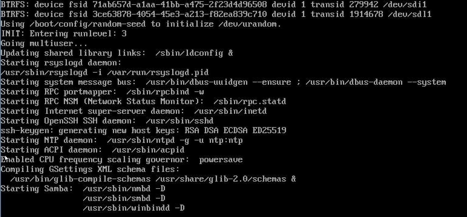

July 21, 20188 yr I updated to the latest stable version and now my system will not boot. This is the prompt it stops at: I have tried to boot in safe mode without luck. Sometimes it will hang at the "strarting RPC NSM" prompt also. I have tried removing all my custom lines in the go file along with the sysconfig file without luck. Any ideas?
July 21, 20188 yr Author It seems to hang up somewhere in that area of the boot. This last time it was at the "compiling GSettings" Will Test Ram and Report back.

July 21, 20188 yr Author 6.5.3 stopped at starting NTP 6.5.2 stopped at the same Network Status Monitor bad usb drive???
July 21, 20188 yr Author Ran it. Found bunch of errors, coverted lost chains to rec files. Ran it again with the switches /f /r /x Completed, ejected, inserted into server. Stopped at starting SAMBA again. I have a backup of the config file. I might just try to move it to a new drive. Any other ideas?
July 21, 20188 yr Author Installed to a new usb key with the installer. Copied my config folder to the drive, ejected, booted on server. Same thing..... Odd Edited July 21, 20188 yr by impmonkey
July 21, 20188 yr Community Expert OK try remaking the new flash drive without copying the configurations files/folders.
July 21, 20188 yr Author Tried to use a fresh install. Same thing. Removed my dedicated gpu, went down to one stick of ram, removed extra nic card, disconnected drives. Same thing. Maybe I need an older version that what is currently on the site. Not sure of the exact version I had but it was older than 6.5.2 Any know issues with the c602 chipset boards? Running a Gigabyte GA-7PESH1 board with dual Xeons and about 96gb of memory. Edited July 21, 20188 yr by impmonkey
July 21, 20188 yr Author Found an old copy of 6.3.5. Copied the BZ* files to the root of the drive. Boots right up. For sure something weird on 6.5.X. Any way I can troubleshoot this?
