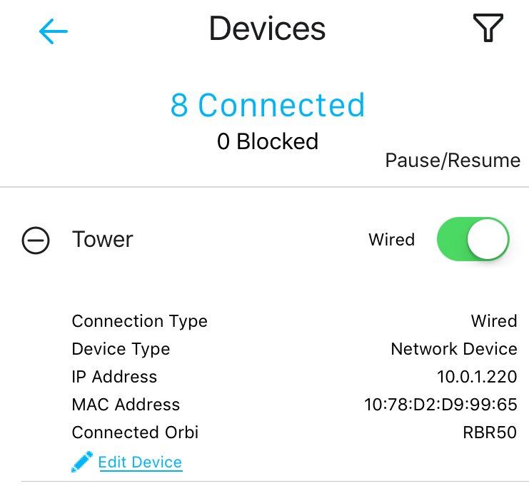

Wireless.  The server has a fixed IP address of 10.0.1.220.  The Orbi is managed from an iOS app, and it sees the server as a wired connection.  Here's a screen shot of what it shows.  I tried connecting via ethernet through the switch as well and no luck either.
