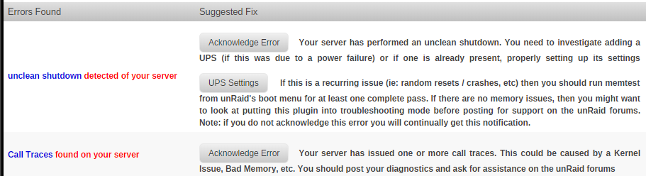

Fix common problems gives "unclean shutdown detected of your server" and "Call Traces found on your server" errors. See attached. No VMs or Docker containers running when it happens. I am copying several terabytes of video from a different PC to a server share, but that's all that's going on when it goes down. I'm going to try to run memtest86 and see if that shows anything. In the meantime, I had Troubleshooting mode turned on and have a few diagnostic logs that I've uploaded. I'm sorry, but I wasn't sure exactly which files to upload so I upload the last 3 diag zip files. Any idea what's happening? Unraid Stable 6.5.3, install not even 24 hours old yet. Thank you for your time and assistance. Please let me know if there's more info needed.  [EDIT: added 5 more diagnostic files per request].

Thank you again. I uploaded an FCPsyslog_tail.txt file also, but I did a clean restart this AM so it's probably useless. I'll check there next. You may be correct on the Power Supply. I ran memtest86+ twice, and both times it completely hung my machine at the 2 hr, 54 minute point, 23% into the pass. That sounds like possibly CPU, and maybe memory as well. But I think you nailed it as a hardware issue. :(
Hang on memtst will be a hardware problem.  If it persists in hanging at 2 hours, 54 minutes exactly, I would be suspect memory first.  You have 8GB of RAM.  I would suspect 2 X 4GB modules.  You could pull one at a time and test that way...
Hmmm. I have 16GB RAM, so if some log is only showing 8GB that's part of a problem already. :) I'll pull one of the RAM modules and test again. Thank you very much for your feedback here, very helpful!
