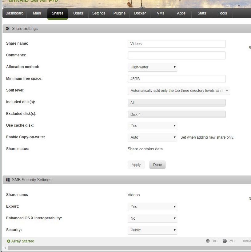

Already, this seems wrong.  If I turn off inclusion and exclusion on the shares page, then *by default* this disk is included in the share.  For instance, I have a top level shares called "Videos", it includes all disks except that I explicitly exclude disk4 which is used as a backup for other computers in the house.  In other words, disk6, the disk I am removing, *is* included in the Videos share, even though it is neither explicitly *included* or *excluded* using the Share settings drop-down menu.  I would have thought that the source disk would need to be excluded from the share to prevent any writes from allocating files onto it.  After all, the array is running and in use during this procedure, right?
Here is a screenshot of my Shares tab:
Note that there is just a tiny amount of time from you removing the drive from inclusions/exclusions until you clear the drive and remove any file systems on it. So it's only during this time you don't want to add new files that might be allocated to this drive. The reason for clearing off inclusion/exclusion is just so the disk will not remain mentioned in share configuration files after you remove the disk.
