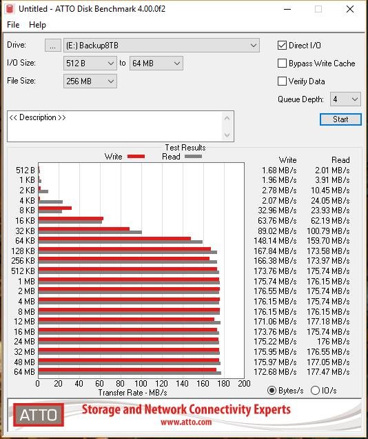

Short info to the community regarding this external disk:
write speed started with around 190MB/s, disk is now filled with around 2,2TB, speed is between 170-180 MB/s
copying around 5TB in one go of movies on mediatower to the external disk via USB3.0
think the bottleneck are the old internal disks in the array
will check tomorrow on my gaming rig with some big files, disk then should be filled aroung 5,3 or 5,4TB
So okay, drive is filled with 5,3TB
Speedtest on gaming rig: copy of "Alien (1979).mkv", file size 26,3GB
Win10pro (up to date)
i7-6700k, 16GB RAM
copy from external seagate to internal Samsung SSD 840 EVO roughly 145MB/s
copy from internal Samsung SSD 840 EVO to external seagate roughly 180MB/s
Edited by hitman2158
