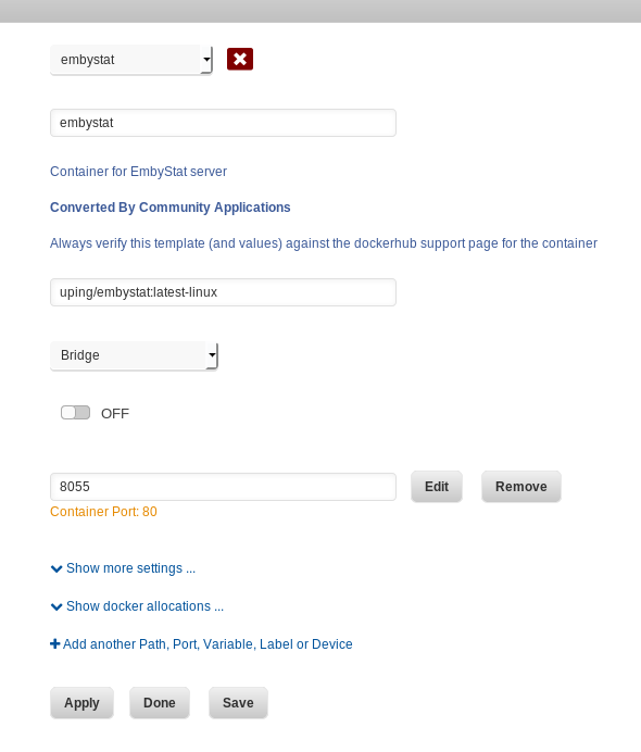

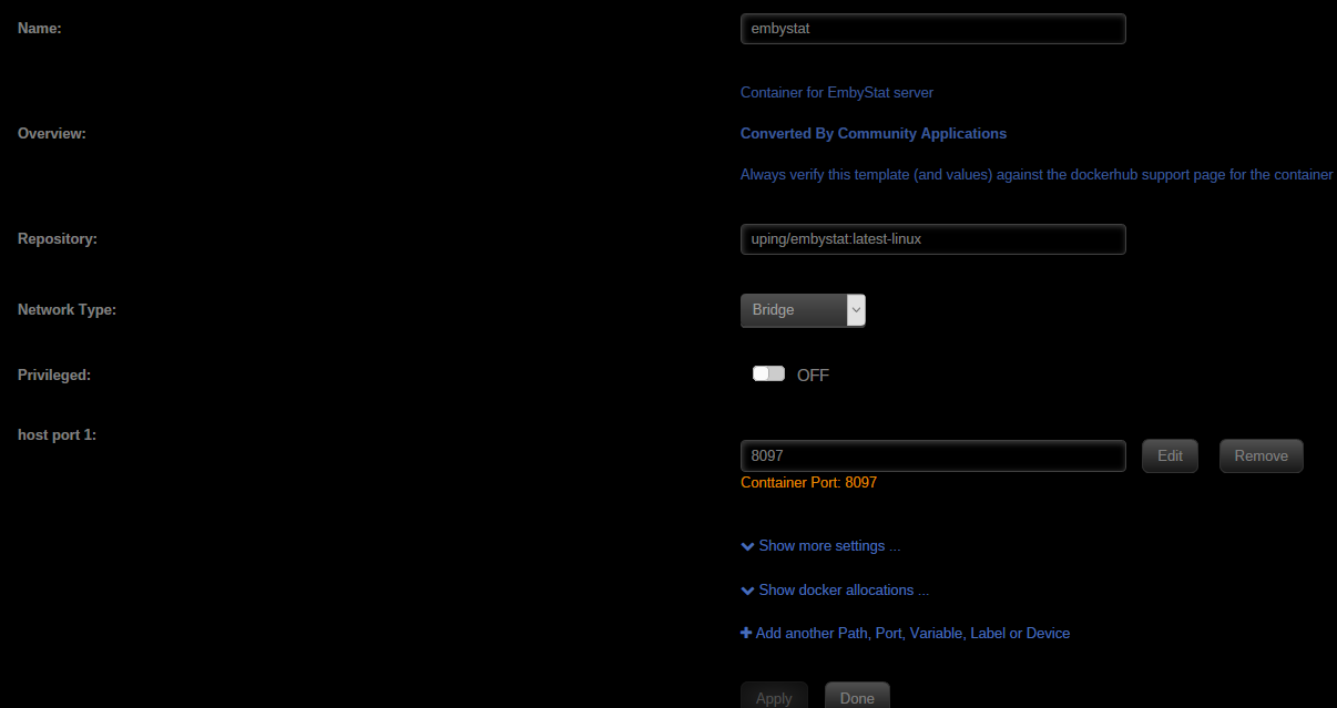

My next problem is, what information do I need to add to the template so I can specify ports and access the web ui.
So I added a host port. I'm just not sure if thats how it's supposed to be done.
And I also added these "keys" similar to other dockers but that made the docker vanish from the docker tab so I changed it back.
I'm sorry if I am annoyingly stupid I just haven't added a docker before, that wasn't in the Community Applications. So from your earlier link I need it seems that I have to create an xml first. So I guess I need to find the info for that on github. Am I on right track?
No need for PUID and PGID as that's not implemented in the container.  This is all the config you need.
Creating the template does create an XML.
I will warn you though, at the moment the way this container is configured, if you update you'll lose your config, and it's very very alpha and probably not worth the time you're investing with it at the moment.
