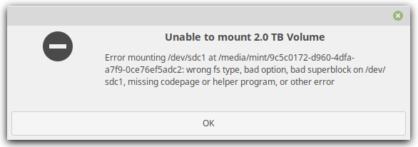

Anyone know if it's possible to recover a bad drive?  I loaded up Mint and plugged the bad drive up to a external port and got an error mounting /dev/sdc1 to mint, wrong fs type, bad option, bad superblock.
Note that formatting the drive doesn't overwrite all of the surface.
So some data may be possible to recover by getting a data recovery program that scans the disk surface looking for the signatures of directories etc. and tries to locate data.
Depending on the state of the old drive, it might be possible to recover some files from it.
And even the new drive - despite the reformat - will after the rebuild have file data on the disk surface even if the reformat destroyed the index information.
How much you can recover is almost impossible to guess. But some of the recovery programs allows you to download and test them and they will then give you some form of indication of how much the program can recover if you pay the full license.

I'm hoping I can mess with the "broken" drive and get some files off of it.  When I plug the drive up to an external dock, it powers on and spins up, but Windows won't mount it, it just throws errors that show up in the event viewer.  I plug it up in Linux, I can see the drive, I can even select it, but then it throws an errors saying it can't mount.  I'm hoping I can get something like UFS Explorer and get access to the data.?
Success!  I was able to get the data off my "dead" drive using UFS Explorer.
