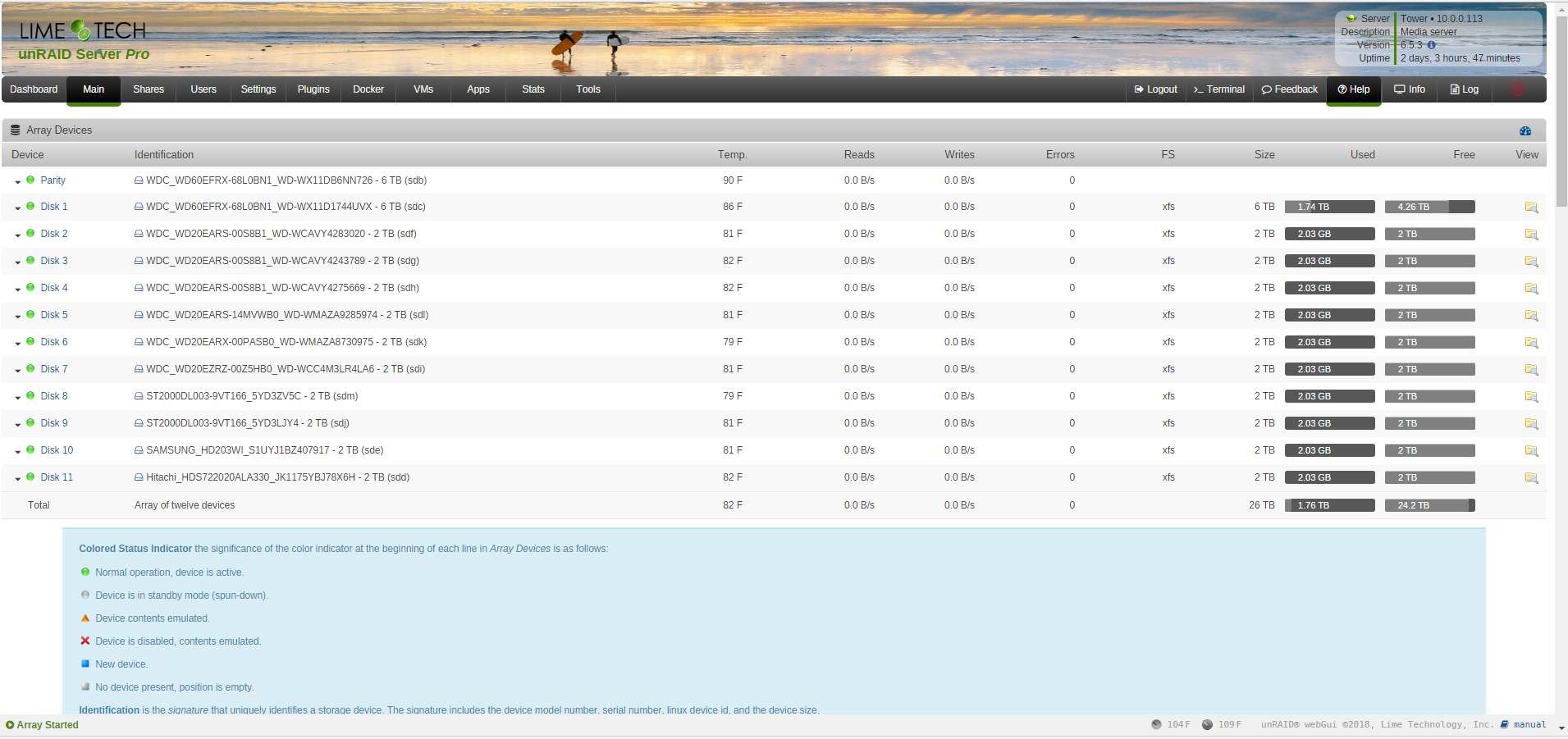

Hi Trurl,
Sorry for the delay in responding.  I have been on vacation and have now gotten things up and running.  It took a bit but I got the Docker installed and have been trying to use Krusader to copy files from my other unraid server.  I am not comfortable with Krusader yet but attempting to learn it. I have copied some of the files to Disk 1 but I think I need to set up some new shares to facilitate using the entire array.

Hi Jonathanm,
You are correct that I was thinking it would handle hot swap.  It was after a complete shutdown and power up that the 11th disk became readable (no disrespect on your instructions I had not read your post with the instructions until after) .  I am now trying to learn the Krusader docker tool as I mentioned in the post to Trurl.  Could use some guidance there.  Thanks!
