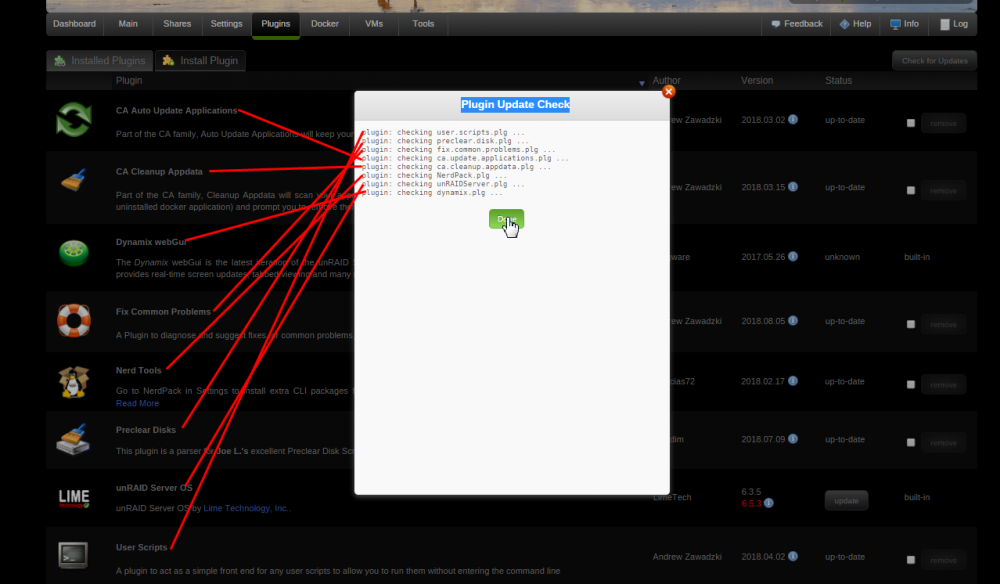

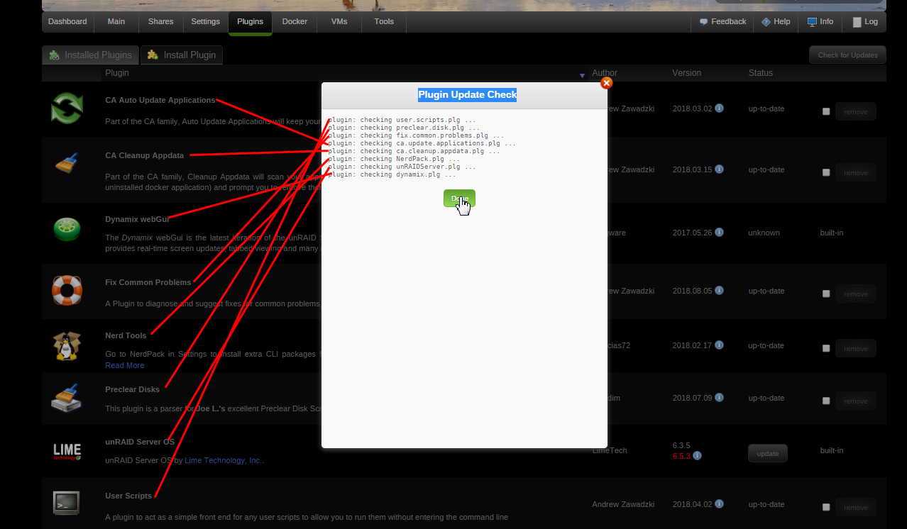

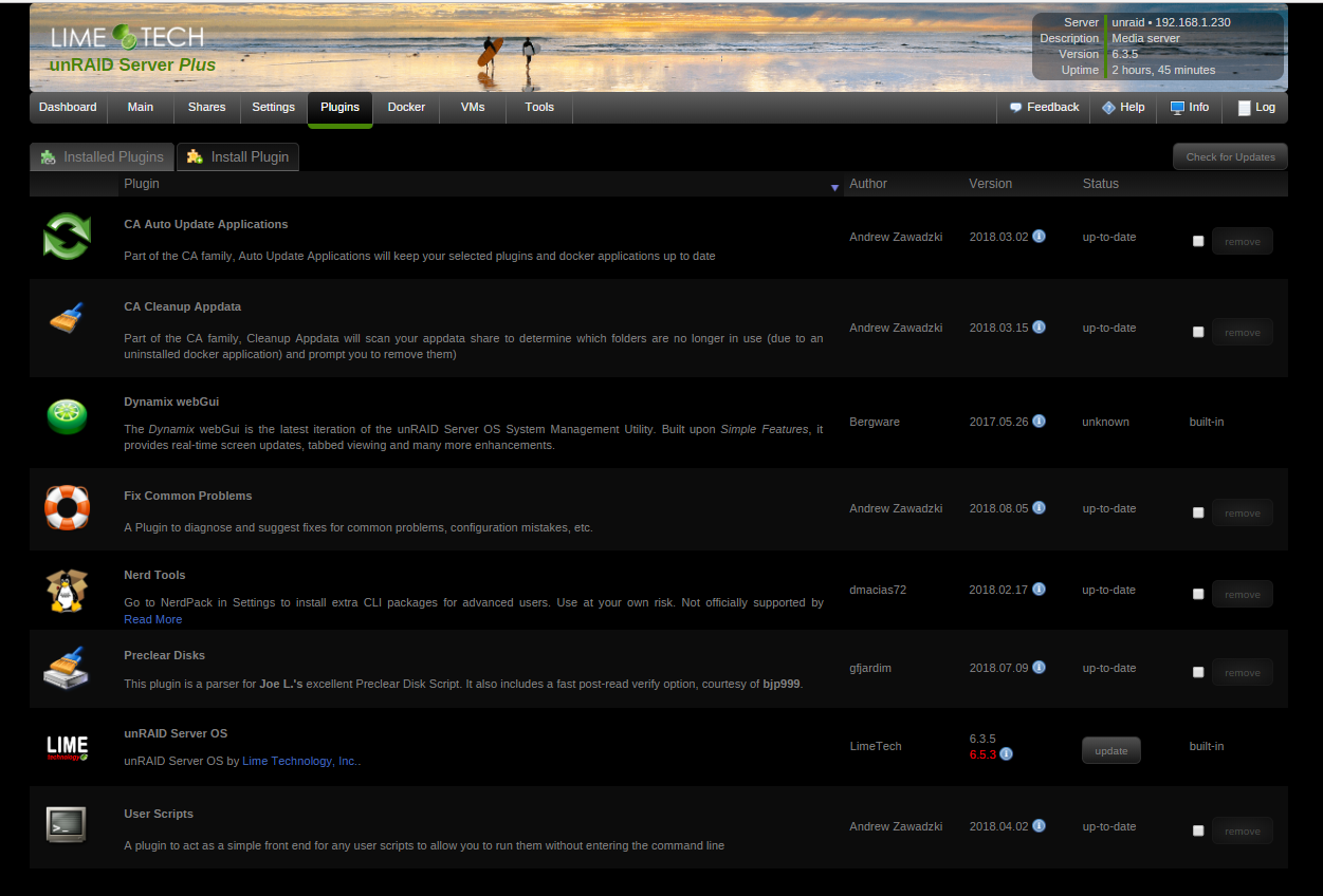

I don't have any dynamix plugins left, except for the dynamix webgui plugin, but that is "built-in" and so can't remove it...   All I have left are the 8 plugins shown in this in the screencap.   Any thoughts on how I can clear this last error?
You can delete that .plg file from the config folder on your flash and it will be gone when you reboot.
When I did the "plugin update check" just now, it clearly shows me my 8 .plg files and they can be mapped to my 8 plugins in the UI.  "dynamix.plg" is the "Dynamix webGUI" built-in plugin.   I don't remember installing this myself, so I'm guessing if must be part of 6.3.5.    You think that's safe to manually delete from the flash config folder?

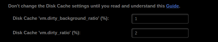

I needed tips and tweaks in 6.3.5 to fix some cache parameters or I would get EOM errors (see screencap).  That was covered here in this thread.  I'm going to assume I still need these disk cache settings in 6.5.3.
