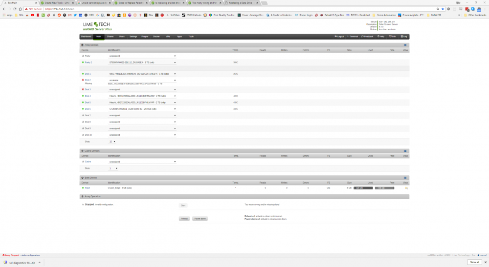

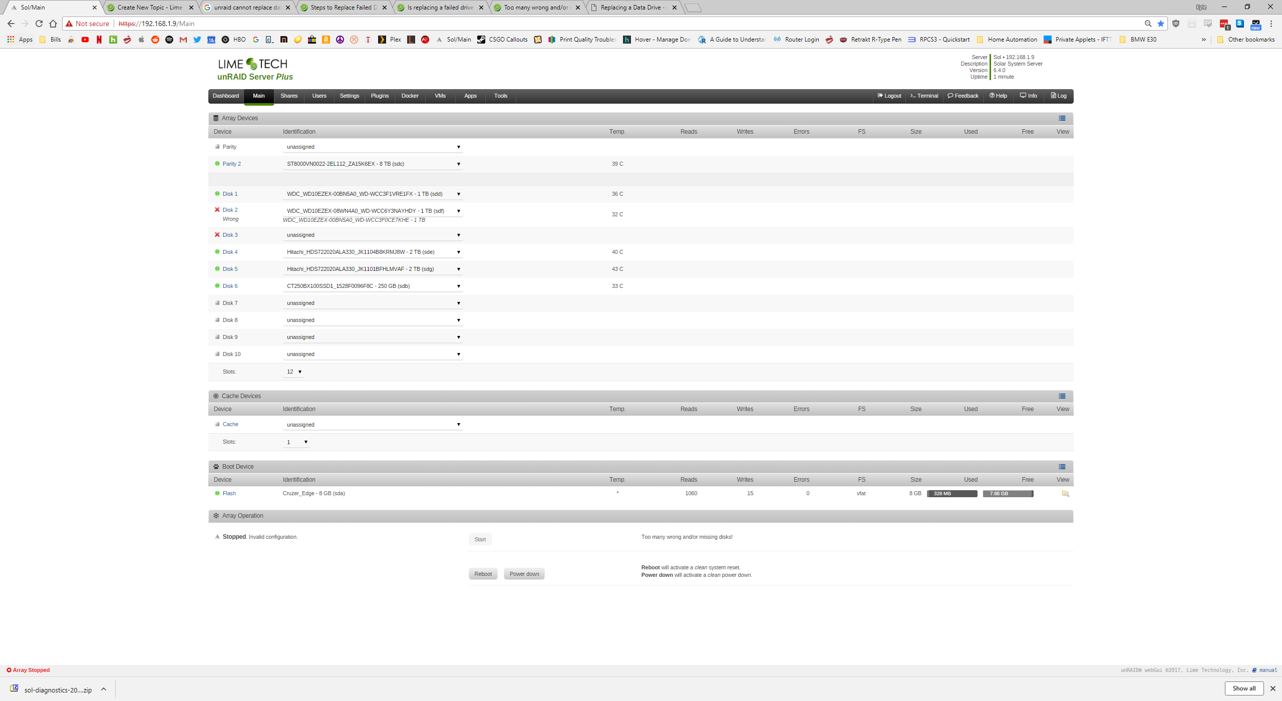

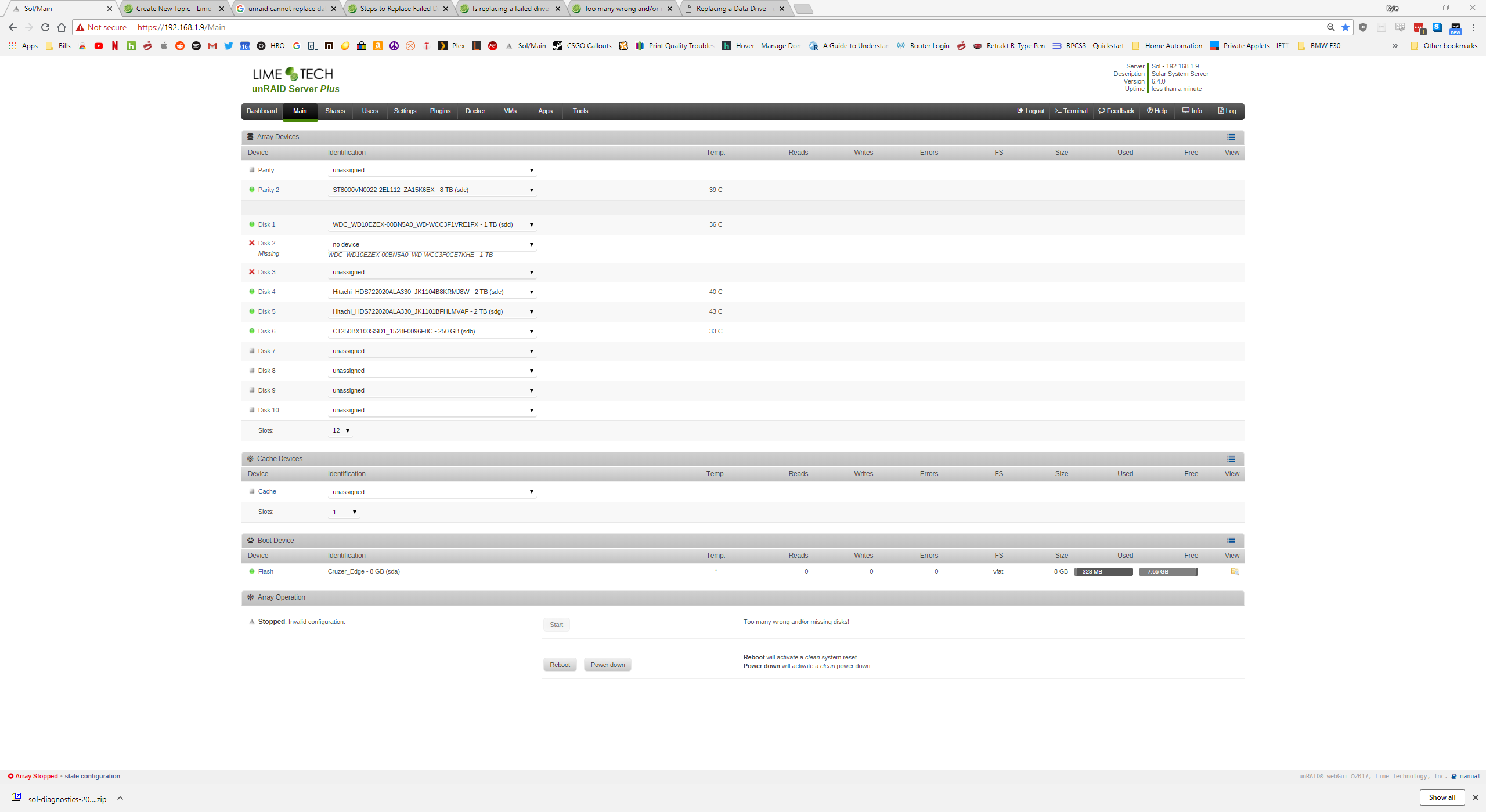

August 26, 20188 yr Hello, I'm pulling my hair out trying to recover my data. I had a drive fail (disk 2), and I was trying to follow this wiki to replace the drive, but I can't complete it the way it is described. https://lime-technology.com/wiki/Replacing_a_Data_Drive The first screenshot shows what my array currently looks like. Keep in mind, that the Disk 2 is actually a failing disk, it refuses to mount due to bad sectors. When I reboot the server and connect the new 1 TB drive to disk 2, I get a warning about my configuration being invalid due to a missing disk 2. See second screenshot for missing disk 2. See third screenshot for disk 2 replacement. I cannot start the array with the new disk. What am I doing wrong? I am unable to attach both of the disks to the system at the same time due to sata port limitations. Do I need to buy a raid card to attach both disks to the system at the same time? I attached my diagnostics for the old drive (grabbed during first screenshot). sol-diagnostics-20180826-1817.zip

August 27, 20188 yr Tell me about Disk 3. You don't mention it in your OP. In the first screenshot you have only one missing disk (Disk 3) and therefore unRAID is offering you the possibility of starting with Disk 3 emulated. In the second and third screenshots you have two missing disks (Disks 2 and 3) and since you have only one parity disk that isn't enough to start the array.
