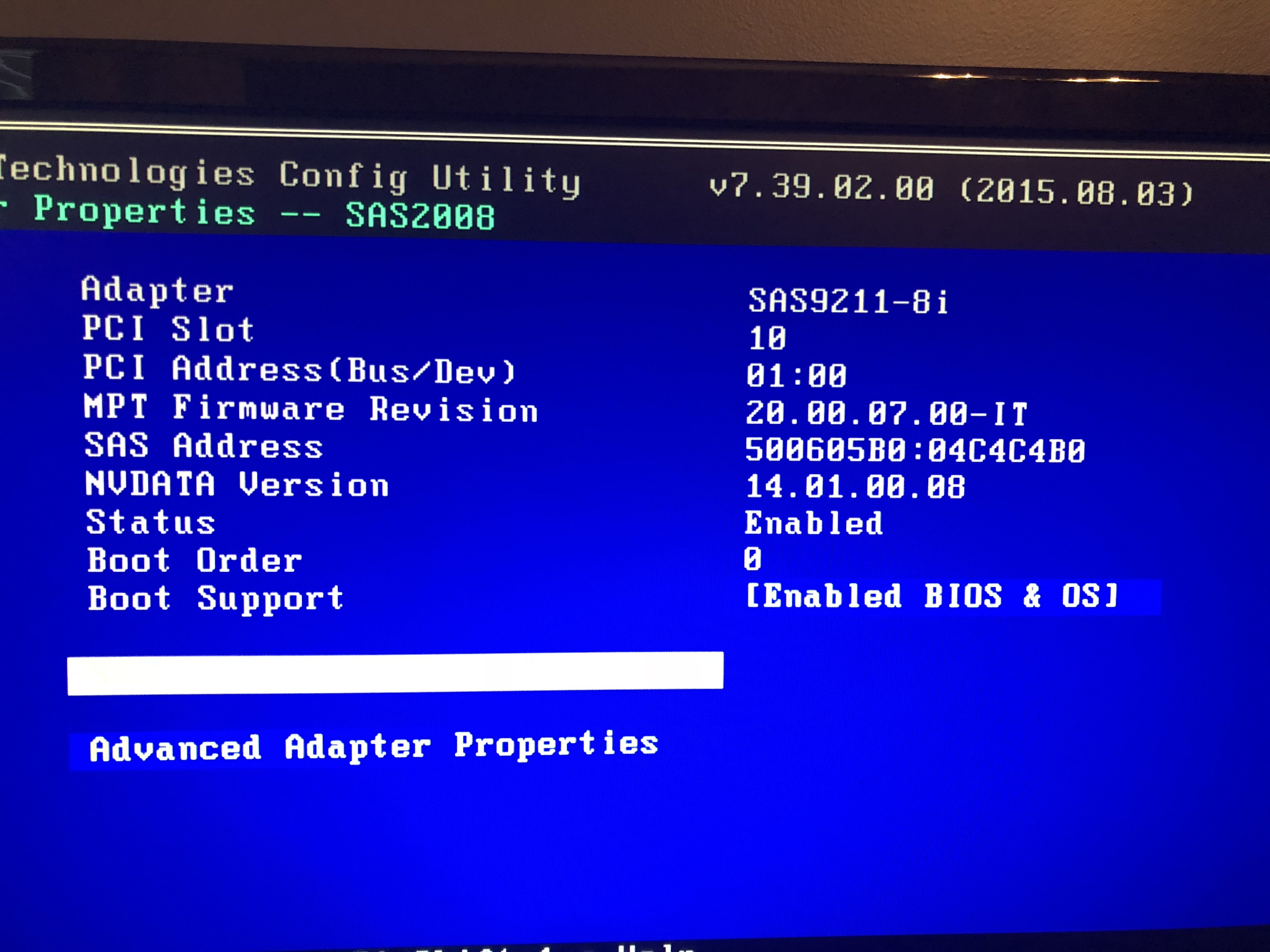

I bought a new hba, lsi 9211-8i in IT mode on latest firmware 20.
My computer sees the device but in the storage utility it doesn’t read any of my drives. The dries are older 3tb drives. I tried installing a fairly old 1tb drive that I know works and it still doesn’t see it. Any ideas?
i haven’t tried changing out my breakout cable but I’d be surprised if both cables were bad.
Unraid reads the card when checking dmesg and lspci but none of the drives.

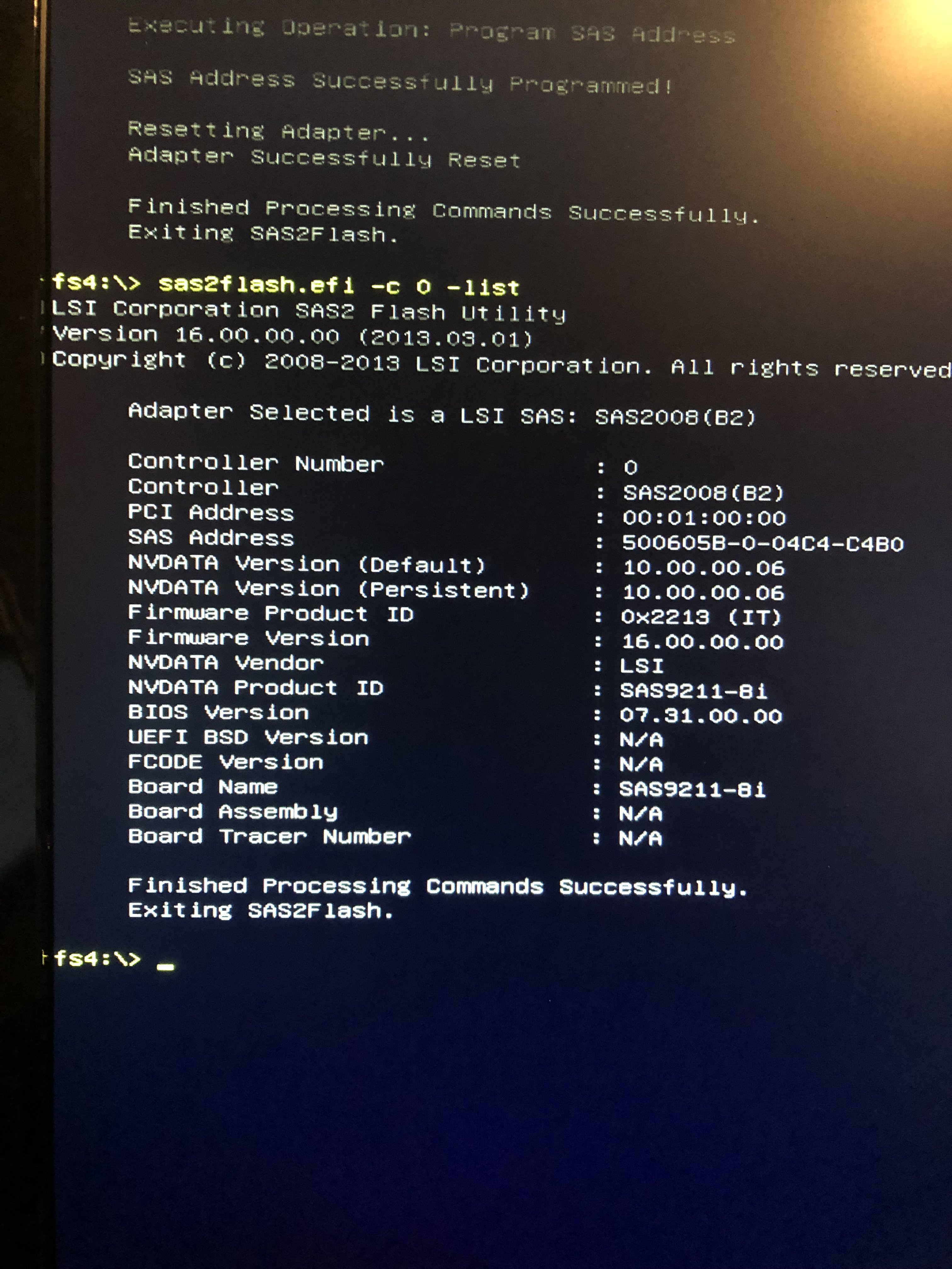

So my windows 10 machine doesn’t read the drives either. I was told in other forums that firmware 20 doesn’t work in Linux and I should downgrade to 16. So I downgraded to 16 and still no luck. I’ve got new cables coming Monday. Any other ideas?
That is not correct, as long as you're using the latest p20 firmware, and you were, it works fine.
