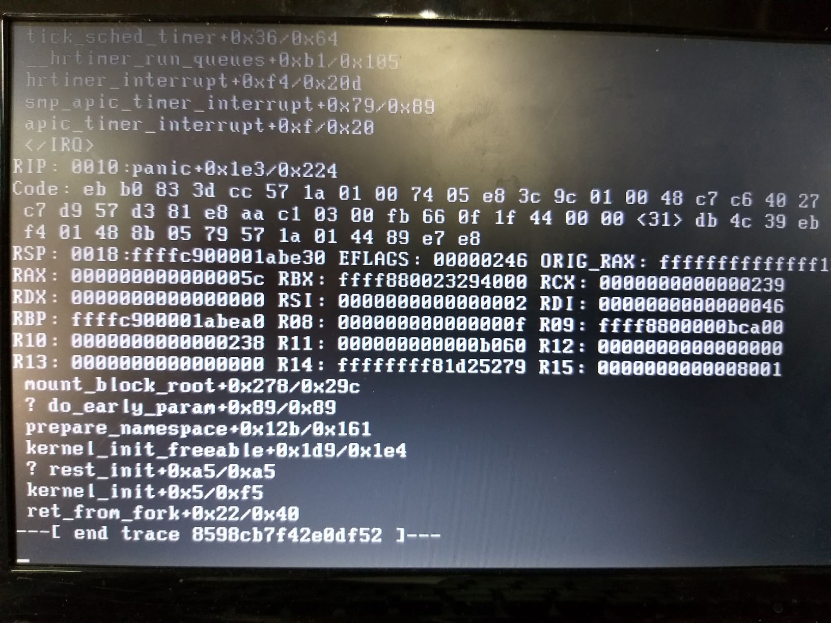

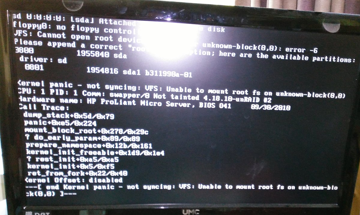

Please take a look at the 2 screen shots. Sorry one is not very clear. The blurry one is the normal boot, the other is with the GUI in safe mode.

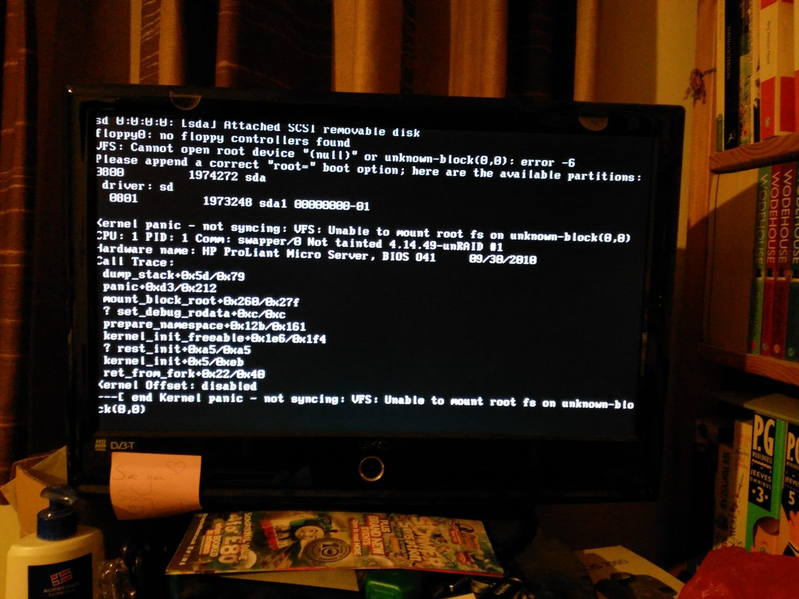

I have tried a third memory stick with an earlier installation of unRAID, 6.5.3.
It still won't work. It also won't work on another HP Proliant server I have. Could it be anything to do with the AMD64 chip?

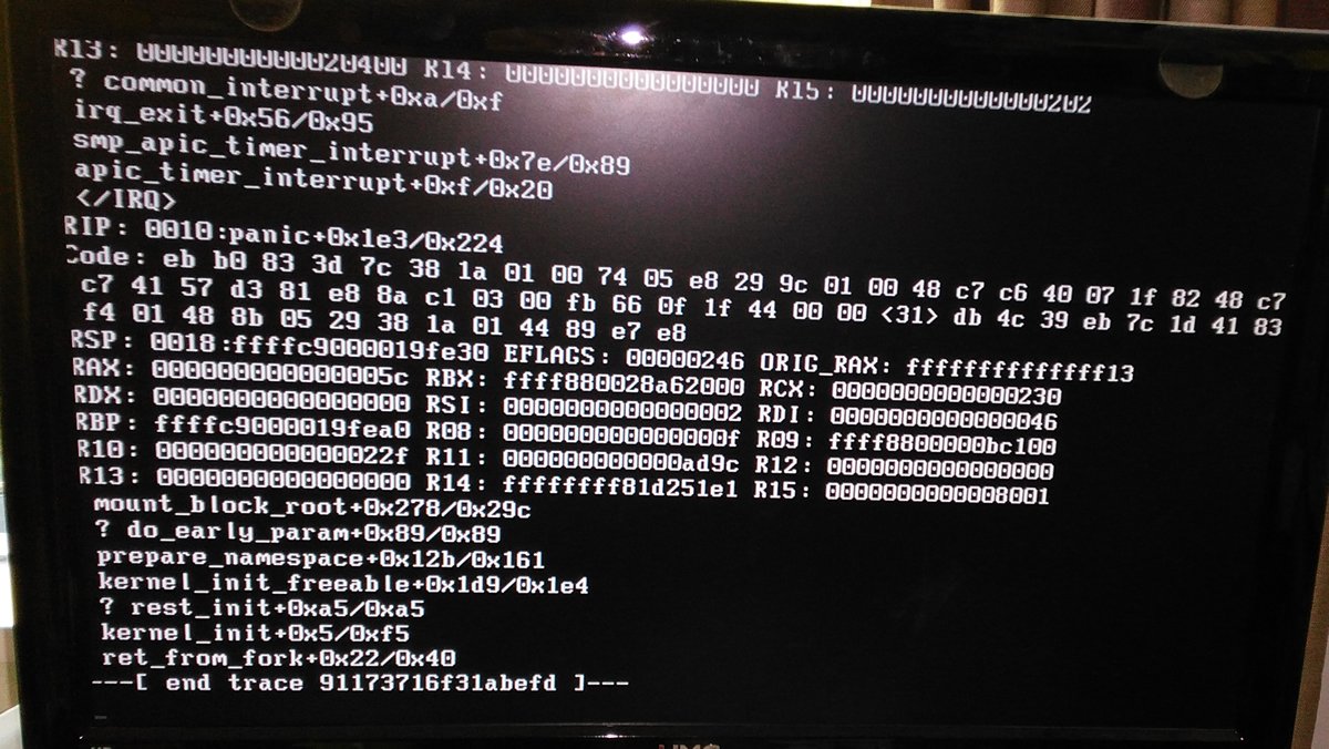

Please see the latest screen photo here. Any more ideas please?
