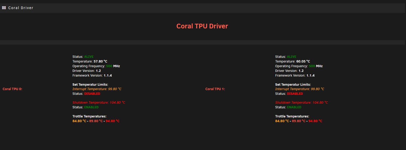

My Coral dual PCIE is not being detected. I have the Coral drivers installed and their details are shown in the attached screenshot.
[QUICK NOTE]
I have just borrowed a friend's USB Coral and changed the config file to reflect this and it worked perfectly.
In the logs the following appears:
