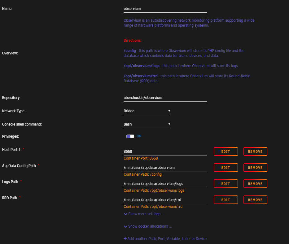

I've gotten Observium CE 19.8.1 working. I've also upgraded the image to MariaDB 10.4.8.

I get the following error in Chrome when I try to connect to an a new docker installation.
DB Error 2002: Permission denied
Have tried to remove the folders in the appdata folder but it doesn't help.

The database hasn't been created yet. Did you stop the container before deleting the appdata volume for observium?
Yes, the container was stopped.
My disk is almost full. How much space is needed to create the database?

I too am having the issue of the default login/password not working.  I've stopped the container, deleted the contents of the appdata folder, and restarted.  I've also deleted the container image and reinstalled it.  Sometimes when accessing the webinterface it gives this error:
DB Error 2002: No such file or directory
A common item I've seen in the logs is this error:
[0;35m o [1;37mMySQL [0m ERROR_FOR_DIVISION_BY_ZERO,NO_AUTO_CREATE_USER,NO_ENGINE_SUBSTITUTION
And then after it's been running for a while it seems to repeat this MariaDB entry:

Attached is a C&P of the Observium log.  I've also tried running the container as Privileged.  I'm running unRAID 6.8.3.
**EDIT** I also haven't touch the config.php in the Observium  appdata folder.  Are we able to point to an existing MariaDB container?
**EDIT #2**  Somehow got it working.  I edited the config.php to point to my MariaDB Container used by other containers.

I also edited with the Observium docker container settings by enabling Privileged, deleted the files except the edited config.php and lo and behold it's working now.  No idea what the problem was.
Observium_LOG_07312020.txt
Edited by kimocal
more details
@kimocal The embedded MariaDB service was stuck in a restart loop. The /config/databases/ea65e1ef1086.err file should show why. I've had this error once before. MariaDB couldn't read the InnoDB files for me. Restoring from backups or creating the database from scratch resolved the issue for me.
This image doesn't need privileged access and works without it.
