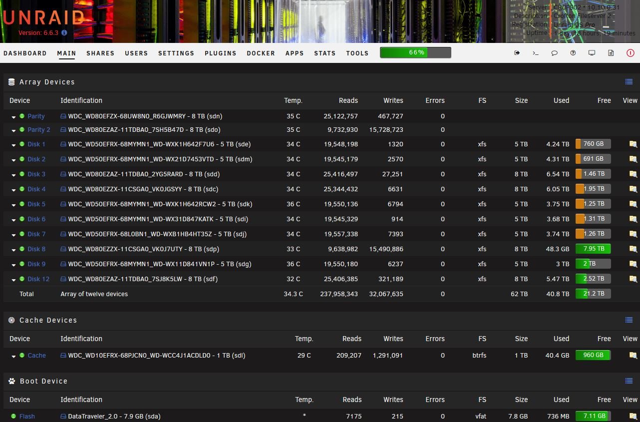

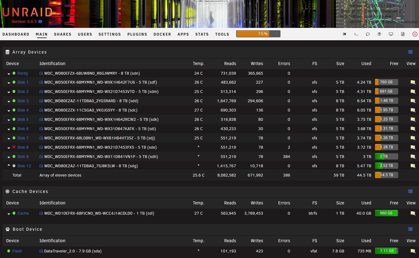

Anyway thought seeing as it had failed for a second time I'd swap it out with another drive, test the "failed" drive and pop it back in again at a later date if everything passed.  It was a 5TB WD Red and as they are quite hard to obtain now I've started replacing them with 8TB drives.  Another drive had gave a few hundred errors but hadn't redballed yet so I thought it would be a good idea to add a second parity drive at the same time before the situation got worse.  I swapped the redballed 5TB drive (ending 3FX5 in below screenshot ) with an 8TB (ending 7UTY in second screenshot below).  I popped the 8TB into another bay as well in case this was causing the issue with the old drive and also stuck in another 8TB drive as well (ending B47D).  UnRAID detected both drives so I added one as a second parity and the other to replace the existing redballed drive.  Hit the button to start the rebuild and away it all went.
Few minutes later I'm checking things and can see another drive has given over 6M errors however hadn't redballed yet.  In a panic that this would cause carnage with a rebuild (and certain the bay had an issue and not the drive), I cancelled everything and popped the suspect drive into another bay.  After making sure everything was still assigned to what it should be I started the rebuild again and there were no errors.  However I noticed once the rebuild was complete that the replacment drive was showing as having very little used space (drive it replaced had about 3.7TB data on it).  Can see there have been about 15M writes to the drive (similar number to the new parity drive) so somethings happened but I don't know what.  Looking at the free space on the other drives not a lot has changed so I'm assuming the second parity drive has been added ok however the failed drive was not rebuilt but everything marked as ok anyway.

When redball drive first seen:
Issue seen after rebuild complete + second parity drive added:

The New disk 8 should show as having about 4TB free assuming the data on the failed drive was written back to the new drive from parity.  So I'm assuming somethings gone wrong during the rebuild and new drive was somehow picked up as an additional drive rather than replacment for an existing drive, am I right?  I've replaced failed drives loads of times so the only difference here was adding the additional parity drive at same time (and of course the errors on the other drive causing me to stop/start the process again early on).
Guess the question now is, am I ok to simply mount the old drive through unassigned devices and copy its contents to the replacment drive (direct or via shares?).  Going by the two screenshots it looks to me like the contents of that drive are missing given the difference in free space.
