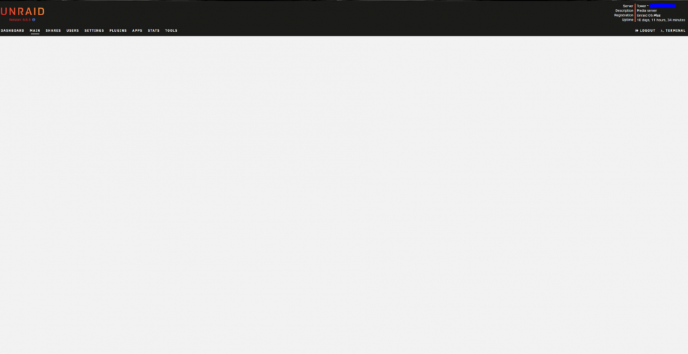

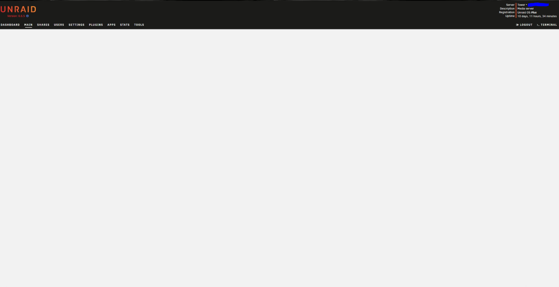

Hi Unraid Community hope all is well. I seem to be having an issue with my unraid server UI when i log in i get a blank screen. only resolved if i restart the whole server using TERMINAL. then about a week later the problem comes back. any ideas? iv tried other browsers with no luck.
Whitelist your server in your browser addons and your Antivirus programs.
Dont have Antivirus and adblocker is paused for that site. :( Also tried on microsoft Edge and wasn't working and i dont have addons on that browser.

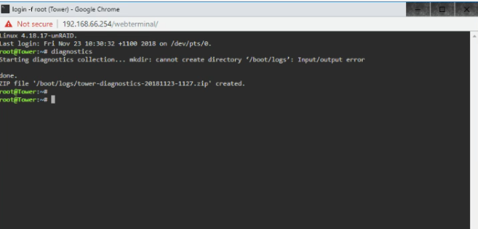

From the terminal,
diagnostics
Then upload the file that'll be stored on the flash drive in /logs

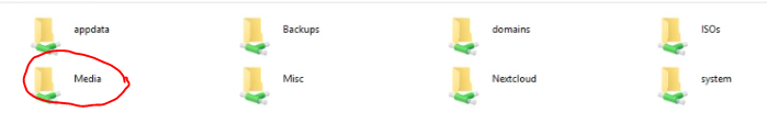

sorry for my ignorance. Due to not being able to get to the UI whats the best method to getting log file off the flash drive? normally i have is passed through as a share but its a reasonably new server and didnt enable flash share option.. and i dont have Krusader running atm to copy the file over. :( The server is remote so i haven't got physical access to it at this time. Would restarting just to get the file be an option? i know that restarting fixes the issue so i wanted to leave it running for troubleshooting purposes, but if needed iv already extracted the file and can restart.
Edited by 666gene
You could copy the file to another share (if you have any other shares configured) if the other shares are configured and accessable.
cp /boot/logs/tower-diagnostics-*.zip /mnt/user/destinationshare

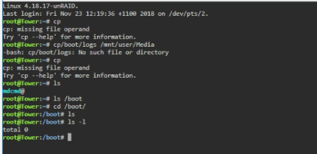

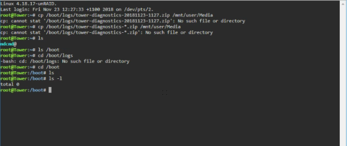

am i doing this right? i noticed that i got an IO error during Diag collection. error showing in previous post. could this be a USB issue?

Yes. Your USB device is not accessible at the moment. A reboot might fix it temporarily but you really need to plug it into a PC and run a file system check on it.
