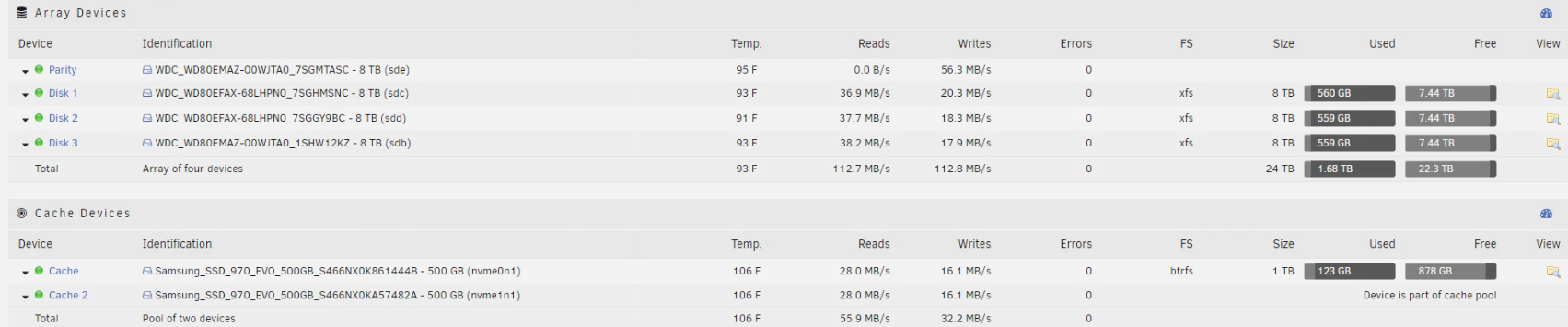

I was wondering I see that my array is running at 10 - 14 MB/s. Is this normal. I know that when I was running my parity I was getting around 180MB/s on all drives. The time this was taken I was using the Mover Service and moving files from my Cache Pool to the array.
I Have Unraid configured to run my Share Allocation method as Most Free instead of the High Water. This is because I wanted the data equally shared on all of my drives.
If I were to add more drives would I expect to see this speed go up. How can I increase the transfer rate?

It's normal if you're writing to all disks at the same time, which by the screenshot looks like you are, possibly using most free as allocation method?
Yes I am what I am wondering is if I add more drives to the array would that number increase or decrease. What I have happening is that because of this slow rate my cache is filling up and causing me issues.
If you care for write speed never user the most free allocation option, when writes switch from one disk to another parity writes will overlap making write speeds very slow, use hight water or fill up and this won't happen, also see turbo write for a faster write method (but still shouldn't be used with most free for best results).

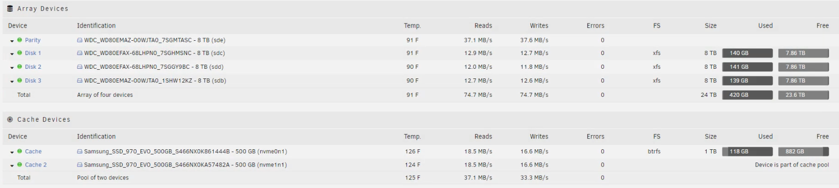

FYI Turbo Write increased my performance by about 40% which is great. I wonder if there is a way to optimize it more?

What are you doing as speed test here?
Sendt fra min ONEPLUS A6003 med Tapatalk
I call it real world speed test lol.
I am transferring data from the Cache Drive to the Array that is where I noticed the speed difference. The file sizes are all the same roughly 1.5 to 5 GB
My point being if it were over network, your bottleneck would probably be network and not the disks with those speeds
It is over the network but I am running 10GB Lan SFP+ the write speed of the Cache is understandable being that I am transferring from a USB2.0 device but the Cache to Array speed is what doesnt make sense.
