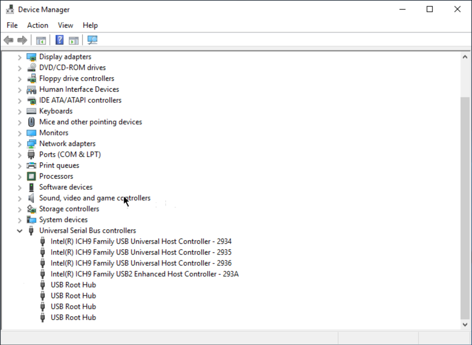

Thanks for the reply.  Well, that raises another question.  When I insert a USB flash drive, the VM doesn't seem to know it.
It looks to me like I have the USB set up correctly.  Thoughts?
