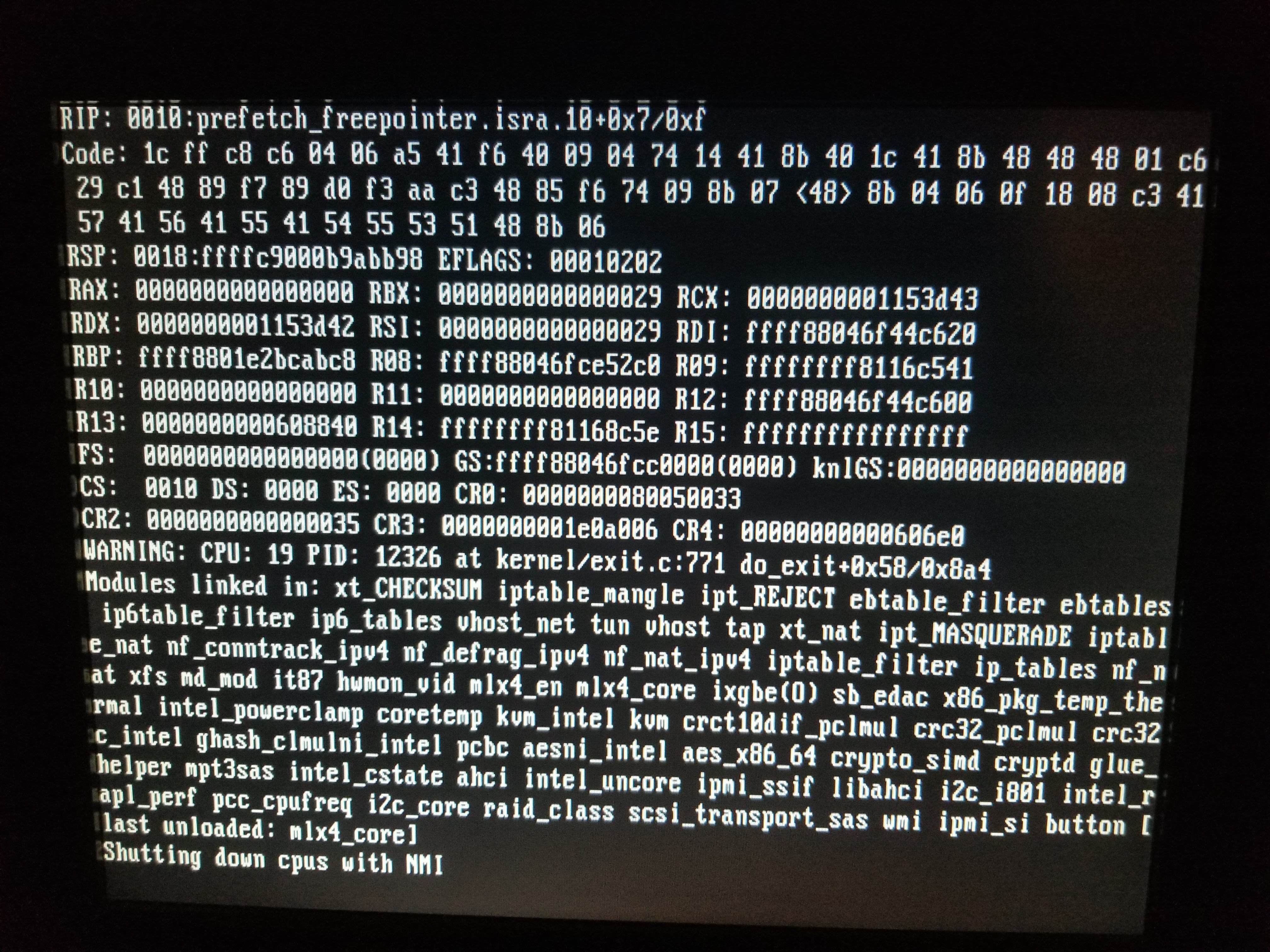

Common thread here is that gigabyte motherboards tend to be problematic.  Literally just had to tell some other poor soul that was likely his issue as well.  Gigabyte just doesn't have the quality assurance/control that Asus, ASRock, and others have.  That said, if you'd like to try some other things, you'll need to boot the system up, get a monitor and keyboard attached, and from the console, type this command:
tail /var/log/syslog -f > /boot/logdump.txt
This will both generate a running log on the screen that you can capture with a camera as well as save that log to a file on your flash device.  When the server crashes again, take a picture of whatever the log has printed to the screen and repost it here.  Likely it will be a call trace and even more likely it will be generic, pointing to a hardware-specific issue, but at least it will give us confirmation that is the case.

Looks like another crash occurred shortly after I left for work this morning. Please see the below picture and attached log file. No virtual machines or docker containers were running.
logdump.txt
Edited by vb543
Uploaded log file.
Server has been stable for about 10 hours. This time array is online but I'm not running a parity check or pre-clear. Would that make a difference?
