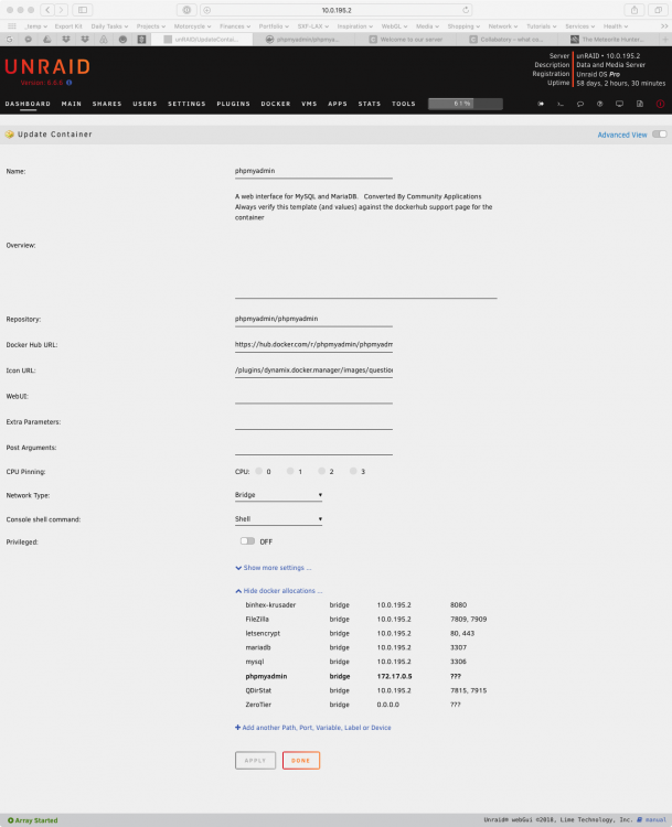

I am also baffled about how to get to the phpmyadmin WebUI after installing the docker...I attached the Advanced View of my Container template and notice that phpmyadmin is the only docker not pointing to 10.0.195.2 and that has no port assigned.
@bender1, you offered to throw up your template...would you mind?

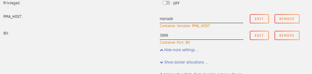

theres really nothing to it.  Just use the official image (phpmyadmin/phpmyadmin).  Add the variable for PMA_HOST and map the port. image.thumb.png.02de6400d83b27e7187e338769f460f8.png
