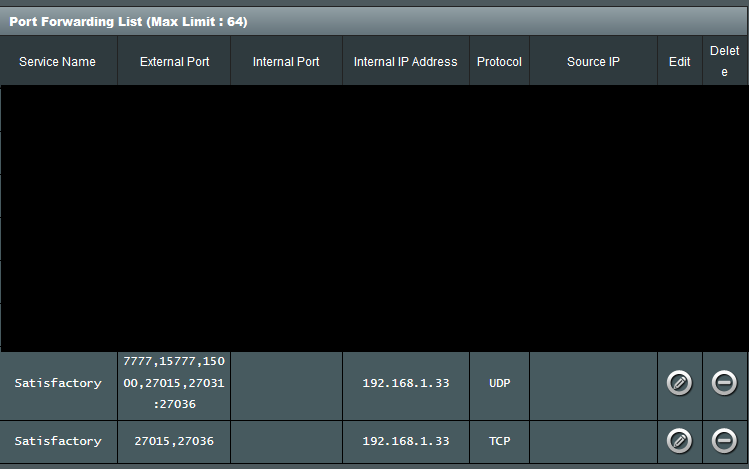

  5. Thanks for the help. I just fixed the ports and limited to what's in the container.
  6. I had found those on some other forums to forward. I'll adjust them though..rather have the absolute minimum # of ports forwarded.

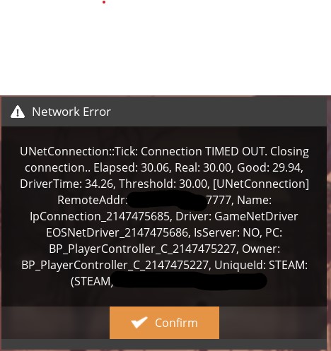

  7. I've been so focused on public connection that I didn't try to connect via my local IP (thanks for the suggestion!). Seems like doing that and having it save is now letting me connect via public IP. Must be something with my connection speed and the size of the initial save....that's all I can figure.
  8. I'm trying to access via public IP. The ports I found to forward I set up below. I just tried to access via local IP and no issue. Could it be a speed issue?
  9. I'm having trouble connecting to the Satisfactory server that I have running. I can get the server to show up in Server Manager of the game, but whenever I try to connect I get this error. I've searched high and low but haven't found a solution that works. I did add these two lines to the Engine.ini file based on feedback I found in other forums but still no luck...any ideas or anyone else have the same issue they were able to resolve? InitialConnectTimeout=180.0 ConnectionTimeout=120.0
