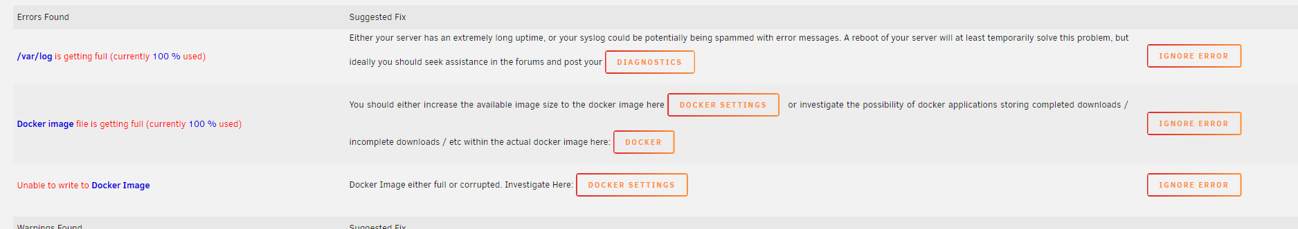

So for some reason that I dont understand my Docker image has reach its full capacity and has no more space, I increased the space to 30GB from 25GB to see if this would continue and it did, I am not sure of the cause, I have attached my Diagnostics zip.
wedge_server-diagnostics-20181216-1322.zip
Increasing the size of docker image will not fix this, it will just make it take longer to fill up. You have one or more of your applications misconfigured so it is writing to a path that is not mapped. You should really reduce your docker image to 20G or less. If you have things working right you are very unlikely to use even this much.
See the Docker Image Filling Up section of the Docker FAQ

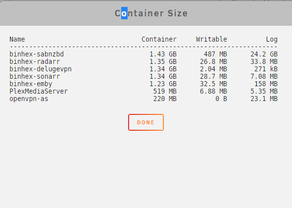

I think it has something to do with the SabNZB docker container, I just pulled the container sizes and I doubt it should be over 20GB.
Excessive logging by docker apps is also discussed in that section of the Docker FAQ I mentioned.
Where did you get this?
Docker Tab, Container Size button
