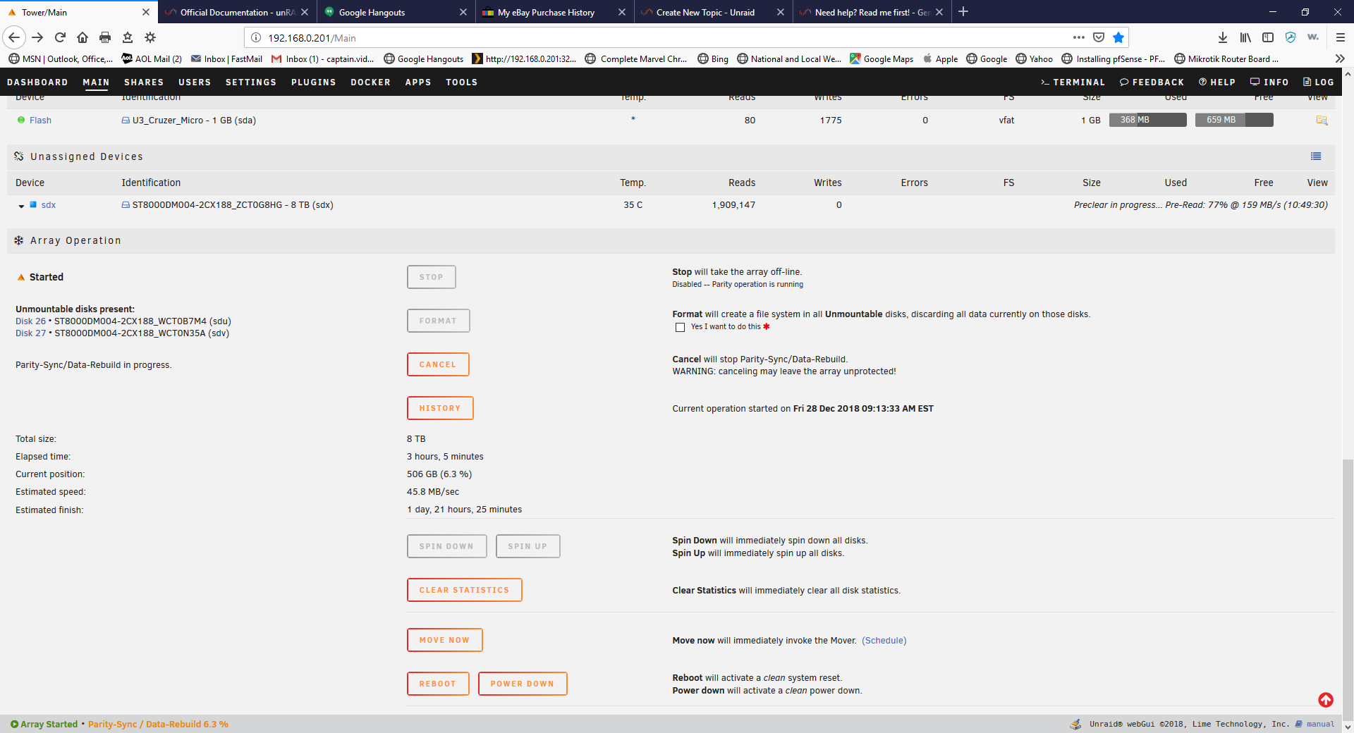

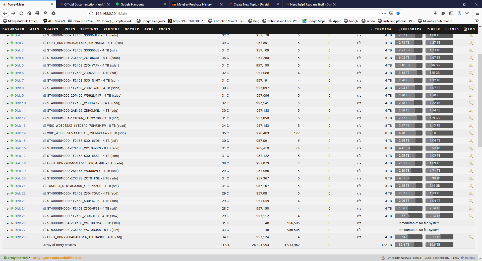

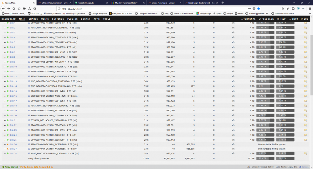

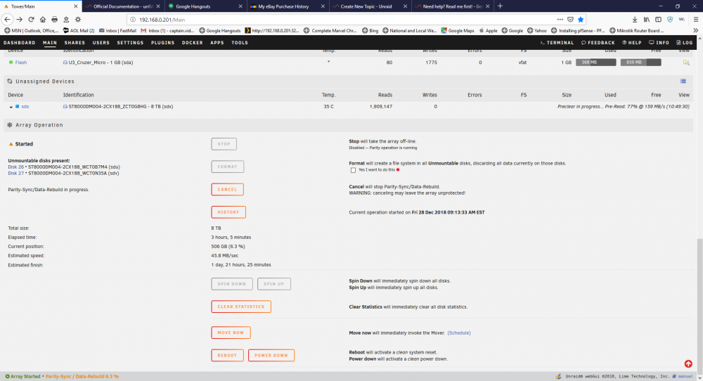

Last night one of the drives in the 5-bay enclosure had a red X next to it in the web GUI.  Under the two columns that showed the capacity of the drive and the amount used it indicated "Unmountable:  No file system."  I shut down the array and swapped out the 4TB drive that had the error with a new 8TB drive that I had already precleared.  I restarted the array and allocated the new drive to the array and started a data rebuild.  While it was being rebuilt, another drive in the enclosure started showing all kinds of errors and an enormous number of writes to the drive.  The new drive was no longer being written to so the data rebuild had halted.  The drive that was replaced was still showing the "Unmountable: No file system" indication.  I shut down the array again and replaced the second drive that was having all of the write errors with another new 8TB drive that had been precleared.  I also replaced the new drive that I had installed as a replacement for the original drive that showed the errors.  I started the array and assigned the new drives to the two slots where the previous drive had been having the write errors as well as the original one with the unmountable file system.  I try to keep several spare drives on hand that have been precleared just for such an emergency.
After a while I noticed that a third drive in the enclosure was having a large number of write errors and now both new drives were showing the "Unmountable:  No file system" message and again it had stopped the data rebuild for both new drives.  I canceled the data rebuild and shut down the array.  I swapped out the 5-bay enclosure with another one that I had on hand and powered up the array once again.  The data rebuild started but I am still getting the "Unmountable:  No file system" indication for the two drives, but the third drive with the write errors was now behaving normally.  It looks like it is going through a normal data rebuild, but I have no idea what data it's putting on the two drives.  I suspect that whatever is being written is simply corrupted and the data is lost.  I would expect it to show the capacity of each drive plus the amount of data to be restored instead of the file system error message.  The display attached to the server is indicating metadata CRC errors and there's another message to unmount and run XFS repair.  I'm at a total loss right now.  I've been running unRAID for over 10 years and I've never seen anything like this before.  I've attached the system log and a couple of screen shots to show the error messages.  The two parity drives are not shown because it would have cut off the drives at the bottom of the screen.  You will notice that I am also running a preclear on another drive in the background.  The total capacity is also being shown as 122TB instead of the previous 130TB due to the two missing 4TB data drives (disks 26 and 27).
