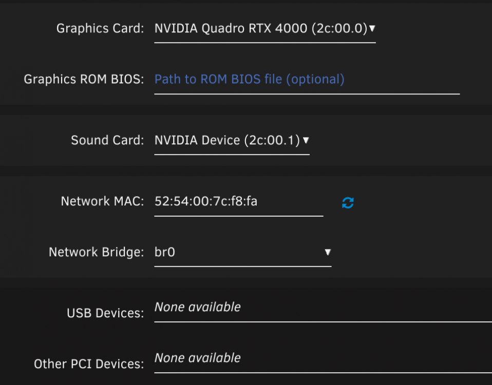

Can you explain this a bit further please?

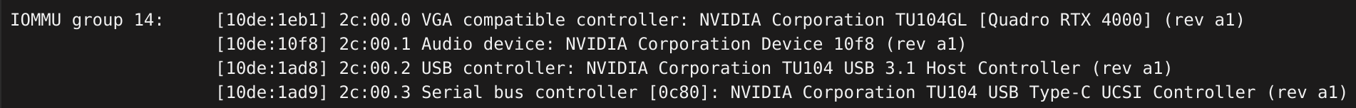

I want to do the same thing using a Quadro RTX 4000 but the USB / Serial bus controller is not visible in the VM settings (no other device is in the IOMMU group):
How to passtrough Nvidia USB / Serial bus controller ?
Sorry, ive not been online here in a while and only just seen that ive been tagged in a few posts.
I no longer use a VM for my workstation for various reasons which are off topic!
(Also I cant remember all the commands, or fully up to speed with the best practice for stubbing and passing devices through in 2020, so im happy to be corrected if any of this advice is out of date!)
I know there's a new way of passing devices to VMs nowadays, but the premise that you have to pass all devices in an IOMMU group will still apply.
You need to stub all the devices associcate with the card, so 2c:00.0 (GPU), 2c:00.0 (Audio), 2c:00.0 (USB) ,2c:00.0 (Serial).
The GPU and Audio are probaby stubbed by unraid in the background automagically (so they'll not have a driver assigned on boot) which is why they're selectable. The serial and USB wont have been, so unraid will be assigning a driver and grabbing the device as its own.
Stubbing then rebooting should be enough for the USB and Serial device to show up in the VM config GUI for you to select. After that, it should pass through and just work.
If they're not selectable, you need to check if a driver has been applied to the device (lspci should tell you). I think a virtio driver is assigned to stubbed devices. If anything else has grabbed it, youve not stubbed it properly.
If they have a virtio driver assigned, its probably just a GUI limitation. you'll need to go into the XML, find where the GPU and Audio device is assigned, and duplicate whats been set up automatically for the GPU and Audio, for the USB and Serial device.
Heopefully thats enough to work with.
