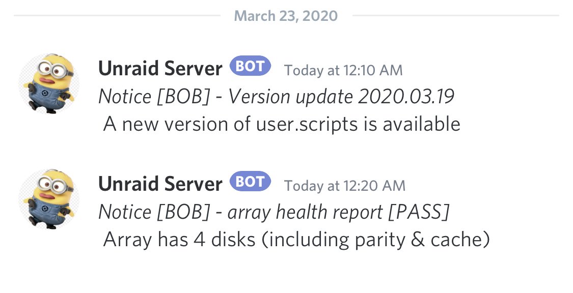

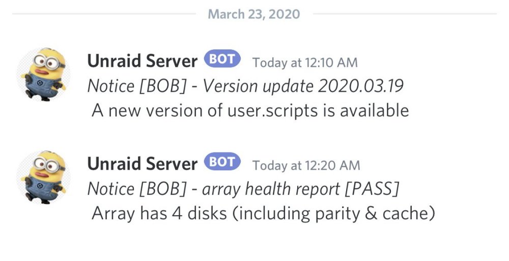

It is still working for me.  However I only send through the Subject and Description.
Attached is what I received this morning for my weekly notifications.
