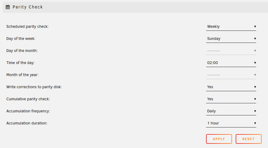

  13. @jbreed you still maintaining this docker?
