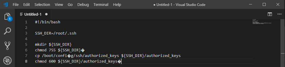

There's a bug on forums that introduces invisible characters to posts, so if you had copied text from a post into a script on your unraid machine, the script may not work--I realized recently this was the reason why passwordless SSH was not working for me.
Example from georgez's post: image.png.3a224db9a38a26332ad3bbc06c56b4b4.png
You may need to manually type it or use a text editor to catch these errors.
