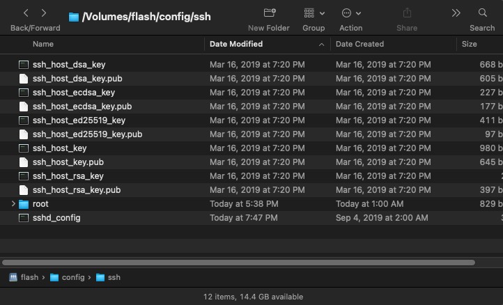

I understand about not deleting them but shouldn't they be moved into the /boot/config/ssh/root directory, which is where /root/.ssh is symlinked? I can't see how they can even by accessed in their current location. I'm thinking they're left over from an earlier method of preserving keys across a reboot, where they were copied into the /root/.ssh directory by a line in the go file.
No these are host keys - what the server uses to identify itself to the user - and all the files in /boot/config/ssh will be installed into /etc/ssh upon startup of the ssh server.
If the ssh server starts up and cannot find these host keys, it will generate new ones and scare anybody trying to ssh in with a warning message about possible Man in the Middle Attacks due to host key mismatch. Needless to say, the new ones will be saved to /boot/config/ssh as well.
For those who use the ssh plugin or know what they are doing, the configuration of the ssh service can be changed and persisted by copying the modified /etc/ssh/sshd_config file here.
If you think the config/ssh folder is full of cruft you can delete the files and reboot, just know that the next time you connect via SSH you'll be told that the keys changed. Not a big deal if you are the only user, might be more of a concern if for some reason you have multiple users.

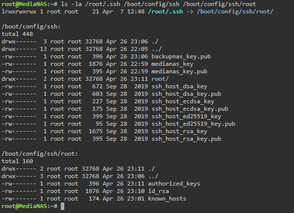

Here's a look at the pertinent directories from medianas:
When I run an rsync command from the script using a test directory (or anything else), it always prompts for a password, thus the script fails.
Not that it should matter as /root/.ssh is symlinked to /boot/config/ssh/root by I tried replacing the id_rsa path with /boot/config/ssh/root with the same result.
The problem is the same in either direction (medianas --> backupnas or backupnas --> medianas).  There is always a prompt to enter the passphrase for id_rsa even though the passphrase was supplied when each server key was generated and each known_hosts file has an entry for the other server.

1 hour ago, Hoopster said:
What am I doing wrong?
Might not be the issue but one thing you should do is to check the syslog for any errors, some plugins change permissions on install and cause issues with key based SSH login, it happened to me recently, if that is the problem you'll see something like this:
Apr 20 18:27:30 Tower15 sshd[15259]: Authentication refused: bad ownership or modes for directory /
Thanks for the suggestion. I do not see any similar sshd errors in the syslog.  I see other errors from a week ago but that was when I was doing some tests and had made a few ssh mistakes.
There is nothing recent in the syslog with respect to sshd.
Hi! I think this is the issue. Normally when I do this I don't put a passphrase on the key. It's not the password of the server, it's a special passphrase to make your key more secure. If you want automation, redo your key generation and press enter when you get prompted for a passphrase.
You can also test with the verbose flags -v through -vvv in your ssh command to give you a little more feedback about what is failing. Try something like:
# ssh -vvv [email protected]
That should sort this out.
Del
Edited by Delarius
I think you are correct.  I set this up over three years ago and forgot the passphrase should be [enter] for automation.
I will have time to test this later, but am fairly certain you have identified the problem.
UPDATE: Confirmed and fixed.  This was the problem, I had entered a passphrase when creating the keys instead of leaving them blank.  I confused that with the requirement that the root account have a password.
Edited by Hoopster
