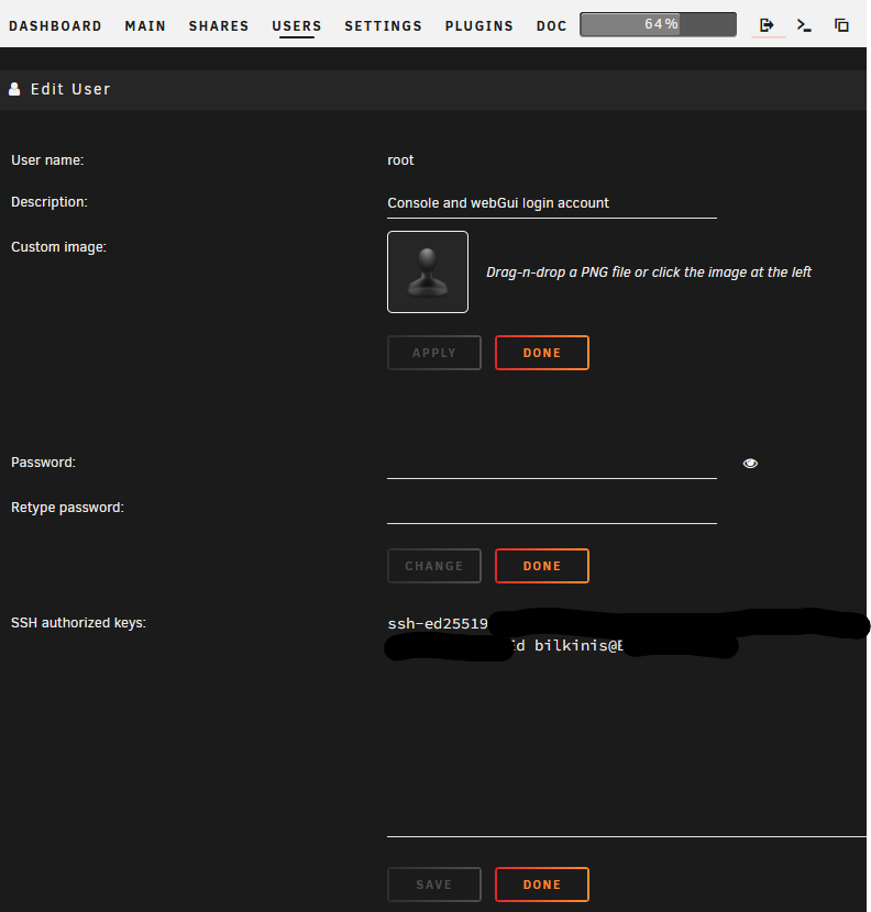

No need for all those complicated steps at all. As already posted, support for this is built into unraid since 6.9.2. I suggest reading and comprehending the following post:

I suggest you READ the previous post.
It seems to work to login with a key. I removed the password in my entry and only selected used the authrized_keys line in the sshd_config. But for some reason, even after changing

I think know with 6.12 all you need to do is copy your public key in the input named "SSH authorized keys" on the users tab for the root user and then save
This should add the key to the authorized list or create the file if it doesn't exist
