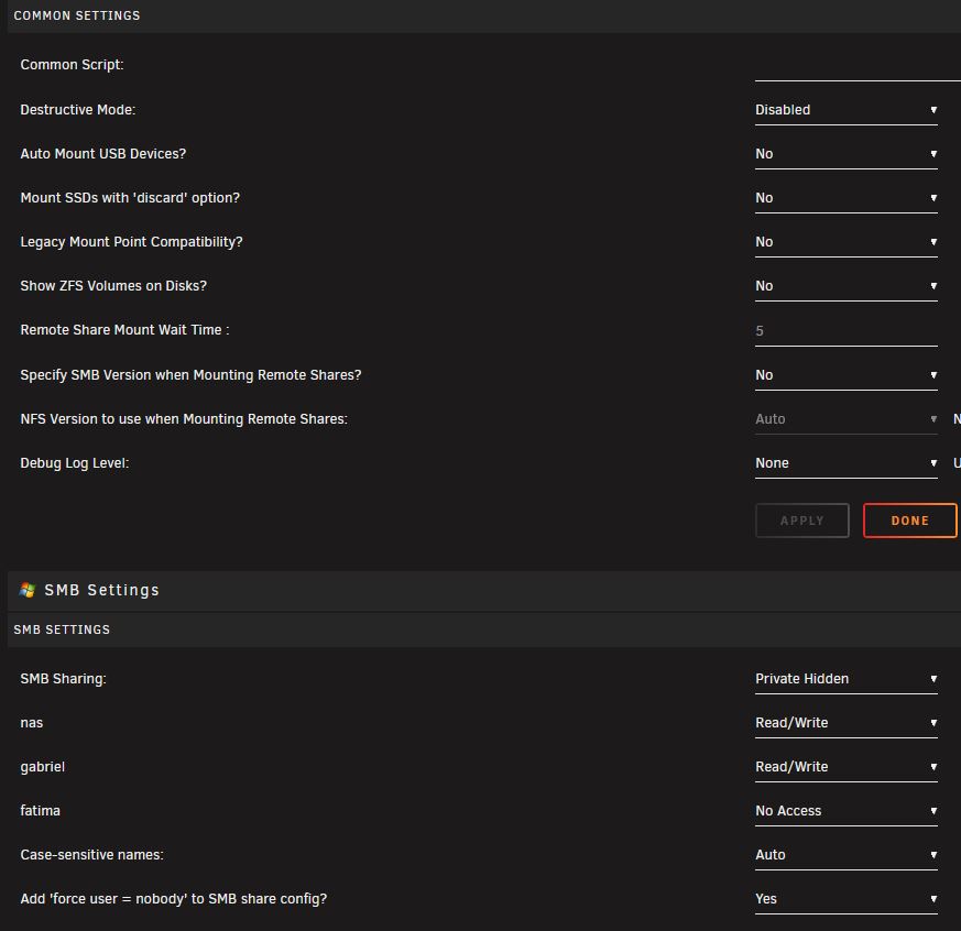

@dlandon the issue just came back with today's update: When I add the share and click on mount, the error "Device '//192.168.0.95/share' failed to mount. Check the syslog for details." appears. The share gets mounted and appears in the /mnt/remotes/ Even after erasing from UD, it still shows in /mnt/remotes/

Rebooted, but it's all the same: When I add the share and click on mount, the error "Device '//192.168.0.95/share' failed to mount. Check the syslog for details." appears. But the share gets mounted and appears in the /mnt/remotes/ Even after erasing from UD, it still shows in /mnt/remotes/
One last update: umount and rmdir worked now! When I try to add the share and click on mount, the error "Device '//192.168.0.95/share' failed to mount. Check the syslog for details." appears. But the share gets mounted and appears in the /mnt/remotes/ Even after erasing from UD, it still shows in /mnt/remotes/
Tried that: rmdir: failed to remove '/mnt/remotes/share': Device or resource busy I'm planning a reboot later today to see if it helps with any old config issue. BR nas-diagnostics-20230817-1132.zip

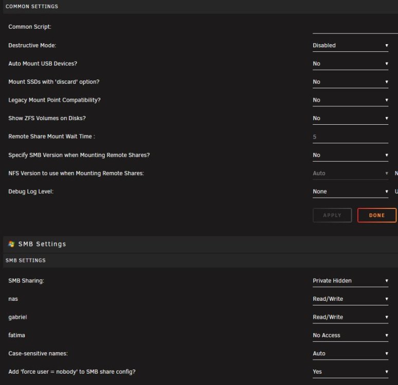

Just an update. Mine is still with the same issue... As Steve said, hidden shares in Windows use the $ at the end of the share name... And there was no issue mounting this kind of shares using the plugin, until recent updates. Since it stoped working, the error was "-- Invalid Configuration - Remove and Re-add --". I've updated the plugin now and the error changed to "Device '//192.168.0.95/share' failed to mount. Check the syslog for details." About the "ghost" mount, I tried "umount /mnt/remotes/share" and it worked, but the root folder for the share is still there... Thanks!

Good afternoon! Anyone else having issues mounting a hidden Windows share? I have this share below mounted for months and since the last few updates (not sure which), it won't mount anymore. This is my samba_mount.cfg [//192.168.0.95/share] protocol = "SMB" ip = "192.168.0.95" path = "share$" user = "nas" domain = "" pass = "7QqlKKHP4F2PVZAs7zvbFw==" share = "share$" mountpoint = "Share" Any sugestions or ideas? Of course, normal shares mount normally. Thank you!

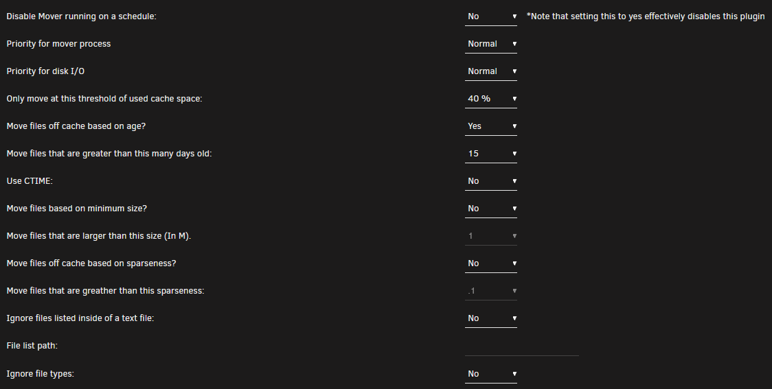

Actually my mover runs once a week with the following config: I've this config for months...but only 3-4 weeks ago I'm having problems. When it reaches 15 days, it moves all files.

Same here! For some weeks now. Any fix? I tried changing all settings and saving again...but when reaches the specified days old, it moves all files regardless of age.
