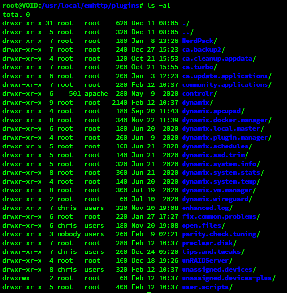

I also just got hit with my first case of "Authentication refused: bad ownership or modes for directory /"
I have SSH'd into this server every day this week and used my public key. Now, with zero changes on my end, UnRAID says my permissions are wrong. I have a second server with the same exact setup and the public key works fine....
I'm mid appdata backup, I'm going to restart after and see if this persists.
I use Termius, but also have putty installed. Updating putty from 0.7.3 to 0.7.4 did nothing to fix the issue.
EDIT: While I'm waiting for the appdata backup to finish I've been poking around and I can't find anything wrong with the ownership of any of the files or folders according to output of ls -al.
I've even tried re-owning and chmodding the relevant folders as suggested above and on other sites, it makes no difference. Public key auth is just flat out broken for no discernable reason.
EDIT: Yeah a reboot fixes it with no changes to my config. Hopefully whatever causes this gets fixed before stable,  its alarming to suddenly not be able to connect to your server.

You are going to have to check each and every single plugin you have installed. Some of the plugins have incorrectly packaged files that muckup the ownership of the / directory.
A quickfix if it hits you is to use the Web-based Shell tool to login as root, then poke around with the permissions of the / directory
Yeah I was able to get in with my password still but I could not find anything wrong with my / directory. Next time it happens ill be sure to get a screenshot and share it so I can get some more eyes on it.
If it was a plugin though wouldn't it affect me from the moment I booted the system? This occurred after 6 days of uptime and multiple uses of the key up to that point. I haven't added or removed any plugins, I think I may have updated one, the parity check tuning plugin.
I took a lot at the Parity Check Tuning Plugin and it was packaged with the nobody:users for all the files including /
Slackware packages are simple tar files applied to root and the ownership and permissions of the folders will override the system one.
I think If you rebooted now, you'd find yourself unable to ssh in
@itimpi You should fix this by packaging as root with the correct permissions
Edited by ken-ji
Interesting. The reboot actually fixed it for me so UnRAID must be correctly applying the default permissions and overriding anything the plugins may be messing with at boot.
I don't have any more plugin updates currently but I will keep my eye out for an update and see if my ssh breaks after applying it.
EDIT: Yeah it was almost certainly the "usr" folder that caused this as I recall seeing that it was the only folder in / that wasn't owned by root. I ignored it as I didn't think that folder would have anything to do with my issue since my key and ssh files weren't stored there.
Edited by weirdcrap
or you have a properly defined plugin being installed after this one. :D
You were right @ken-ji
My other server hadn't had the parity check tuning plugin updated yet so I installed. Sure enough I lost pub key access and my usr folder is owned by nobody:users now
EDIT: So I went digging into the folders it seems to have touched and I ended up in the plugins folder and it looks like some of the other plugins ive installed over the years aren't owned by root either. Is it a rule of thumb that all of these files should be owned by root? Or is it different from plugin to plugin?
Edited by weirdcrap
The mkpkg command is being user with the option to force 'root' user so they should install fine and have the correct permissions, but I will check this out anyway.
