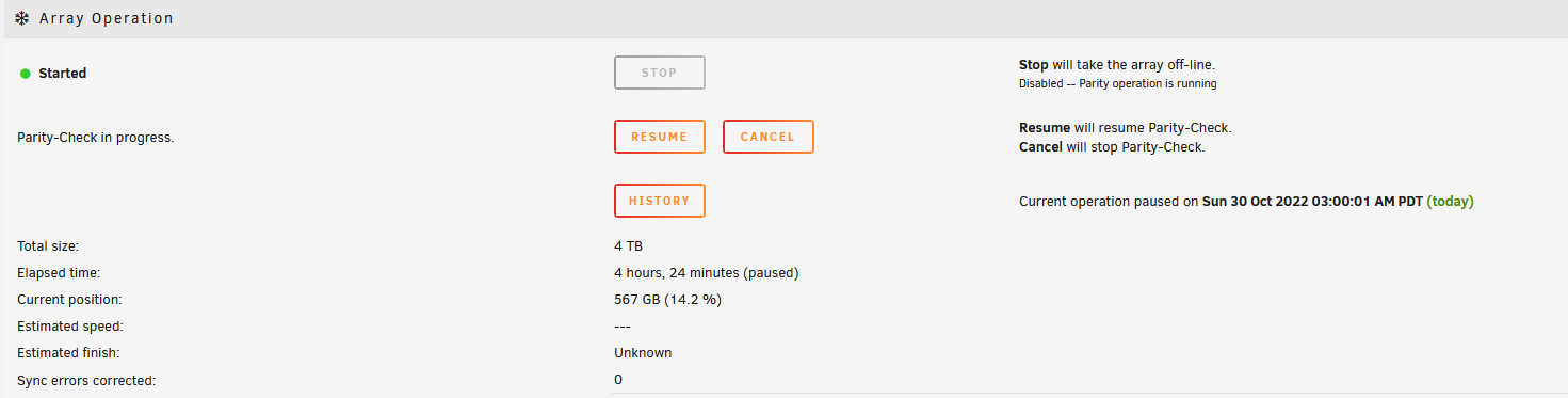

  6. Guess that makes sense. It's the Accumilation duration? That's set to 1 hour: This is a "new" setup. So all parity should be pretty default?
  7. Thanks for your reply. I though i had deinstalled nerdpack! Thanks for noticing. I did sometimes need to manually unrar files, so i used unrar. But have that installed now via a package manually as explained in the threads. What things could cause the parity check to pause? -edit- My parity check was planned on Sundays, 02:00 and Mover daily on 03:40. Think that might have been it? Changed mover to 01:00. See if that works
