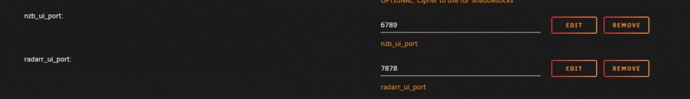

  19. Which config pieces from gluetun are you looking for, since it is really long!? Below the port mappings. GUI is working fine for them.

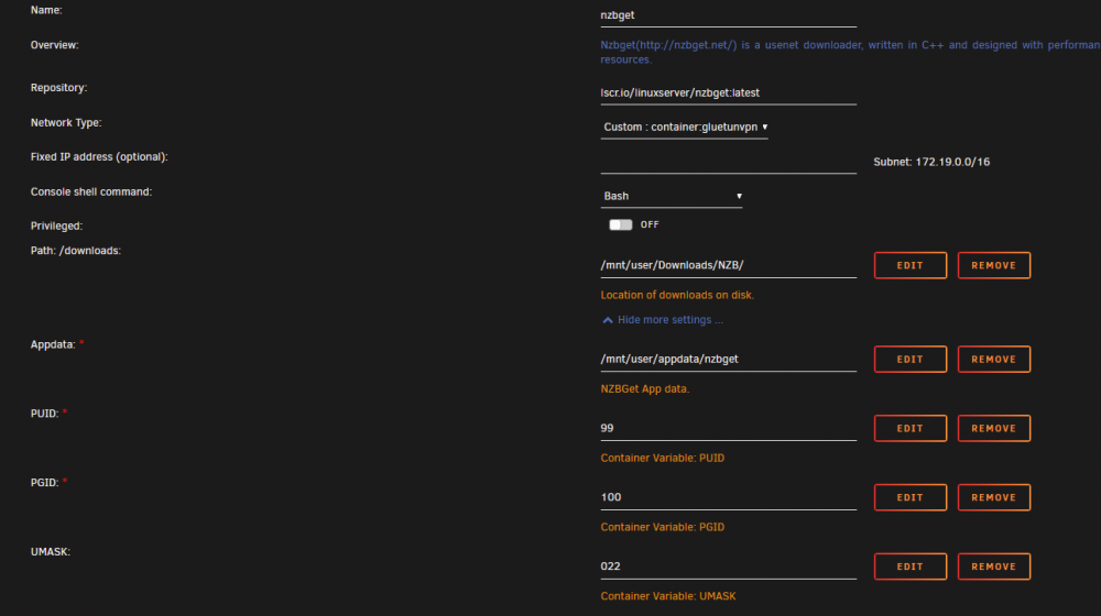

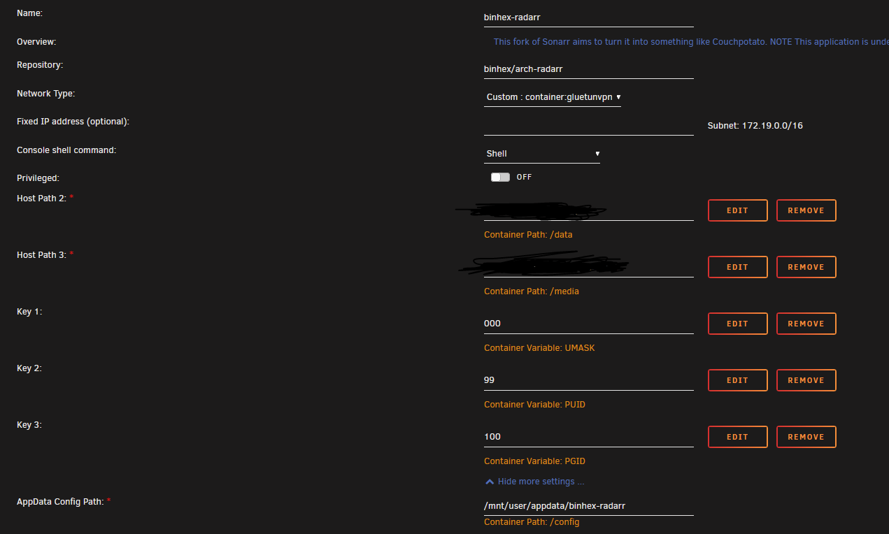

  20. Trying to setup nzbget and radarr running through GluetunVPN Container. As long if only nzbget is using the VPN container everything is working fine, but when I force radarr to use the VPN container as well it is not working anymore and Radarr cannot communicate with nzbget anymore. I already tried using external parameters (--net:conatiner:xyz) as well as setting up a new docker network. Any ideas?!
