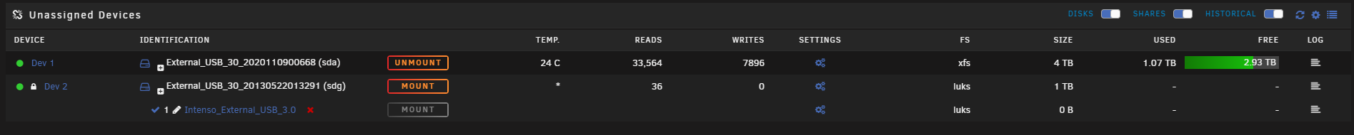

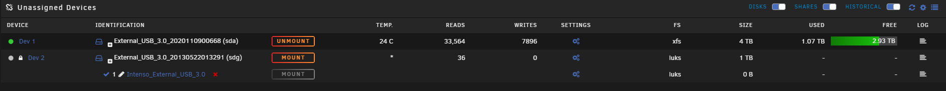

Here you go....- Unassigned Devices - Managing Disk Drives and Remote Shares Outside of The Unraid Array
