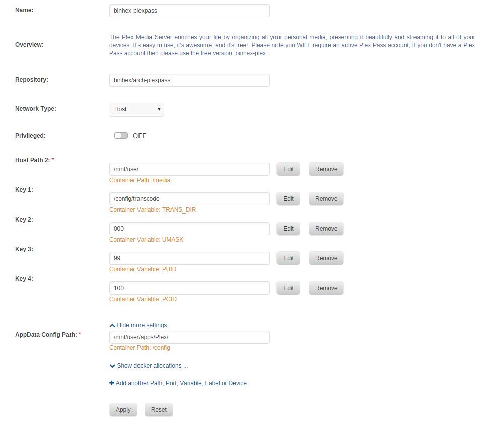

5 minutes ago, trurl said:
Host path 2 as it is in the screenshot is going to make your /mnt/user appear as /media inside the plex container, but the database you already have is expecting your media to be at /mnt/user. So you need to edit that mapping and change the container path to /mnt/user.

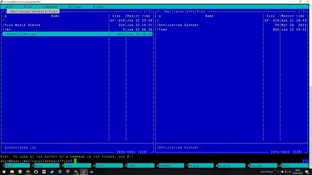

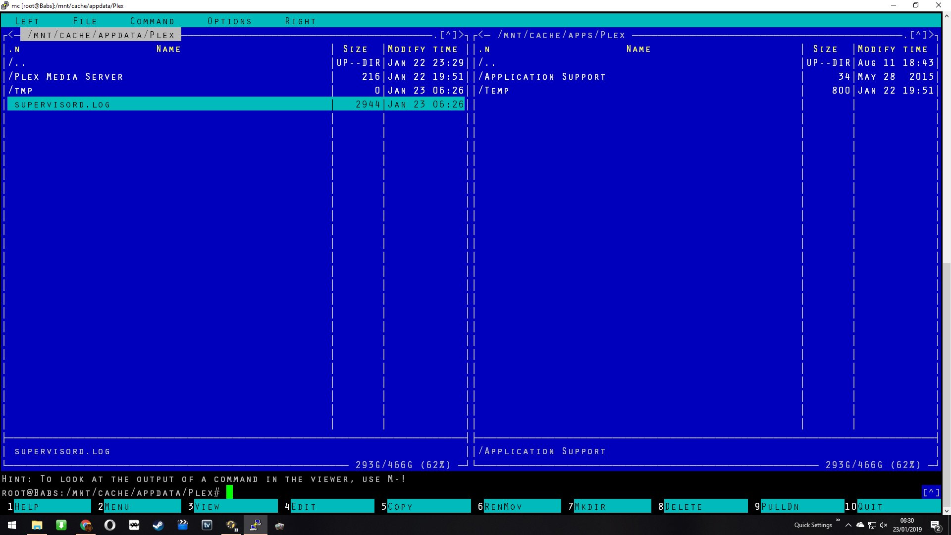

Had the same thought last night, so I moved some stuff around to match how the new docker has it.
MC screenshot shows appdata on the left (docker) and apps on the right (plugin)
In "apps" there is a folder inside "application support" called "Plex Media Server" so I just copied this across.
And voila it worked kinda.....more on that below

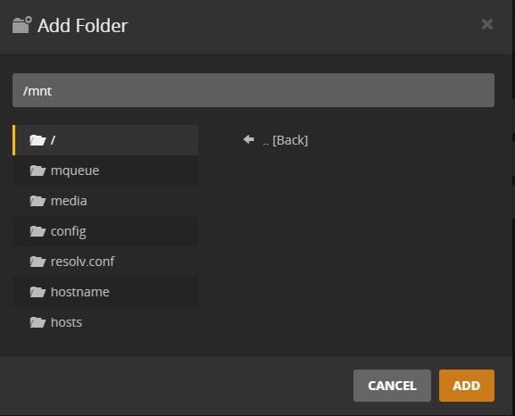

Upon further testing though, something isn't quite right, the file structure is different so none of my media is linking up.
mnt/user doesn't seem to exist? as you can see below, this is what Plex is seeing under mnt I'm guessing I've got the wrong path set? (/mnt/user)

How do you have that mapping? We discussed changing it but I don't know if or how you did.
Not totally sure....i set my "host path 2" set to "/mnt/user" (due to the plugin being set up this way I assumed?) as per here:
Edited by zapp8rannigan
The host path is right, but you need to edit the container path and make it /mnt/user also since that is where your container using the old library will expect to find your stuff. Click the Edit button.
Genius, sorted and up and running. Thank you so much :)
