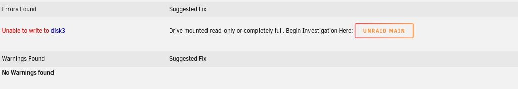

I checked  fix common errors shows disk 3 being mount as read only or out of disk space yet it still has 135gb free on it...
how this error come to be
A disk will be mounted as read-only if corruption is detected at the file system level.    You might want to stop the array; restart the array in Maintenance mode; click on the drive in the Main tab; select the option to run a file system check.
if that does not resolve your issue you should post your diagnostics ZIP file (obtained via Tools->Diagnostics) so we can see what is happening.

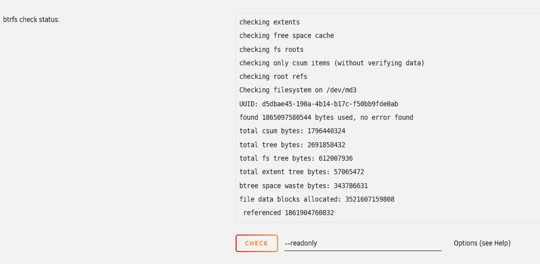

so o started in maintance mode and then ran file check on disk 3
didn't see nothing... so now what??? here is the report I guess?
If it goes read only again, and it will likely will, grab and post diags before rebooting.

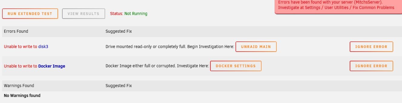

I rechecked fix common issues and this is what it shows now
im guessing from that folder viewing of each drive.. the dockers are on disk3  and that's the drive that's giving issues.  yet its not full..  its just going in read only... is the only way to fix is start over with disk 3  like get new hard drives.. as its a 4 bay enclosure....
