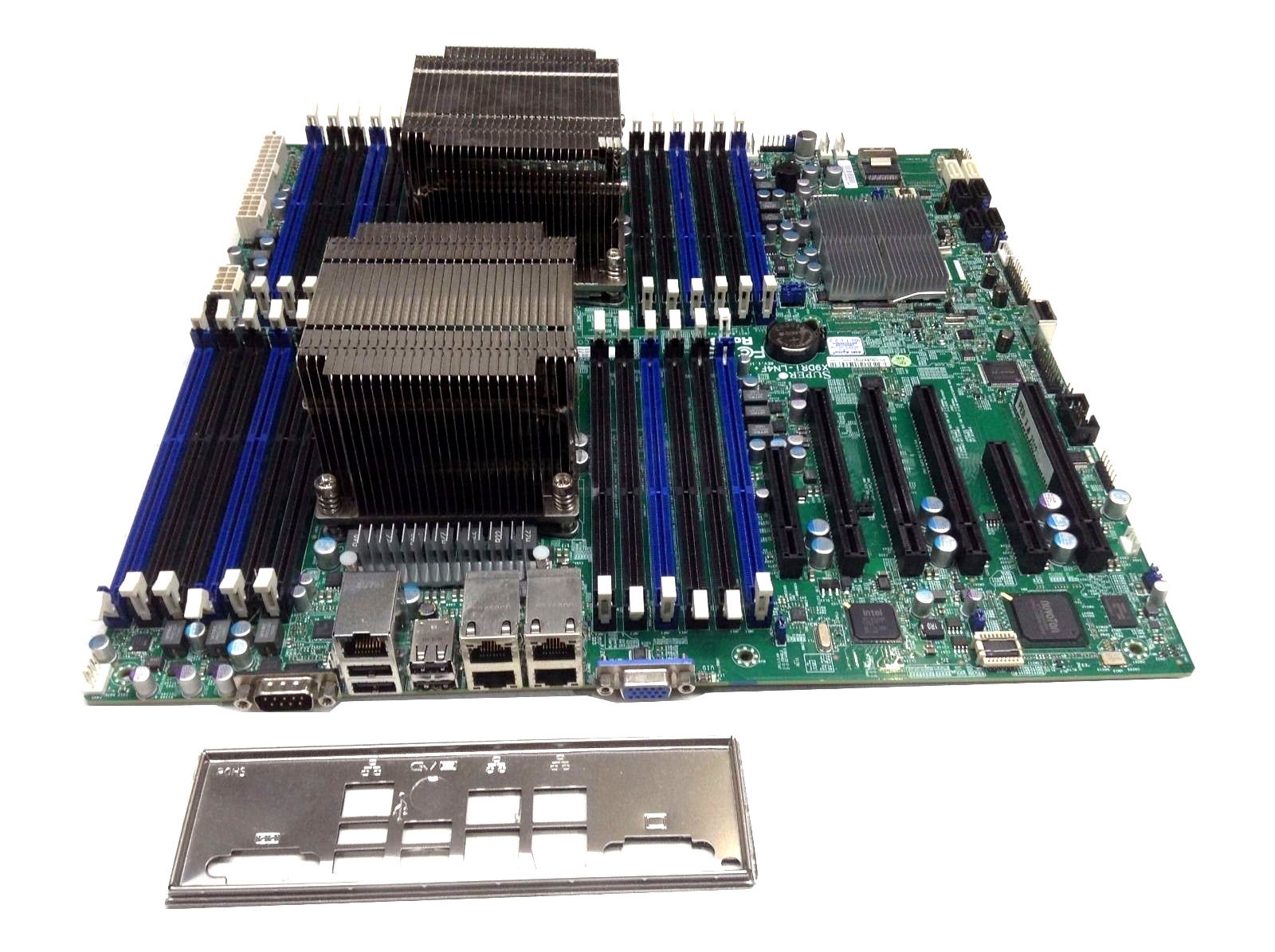

What are your thoughts on something like this:
https://www.ebay.com/itm/Supermicro-X9DRi-LN4F-Motherboard-2x-E5-2690-v2-3-0GHz-10Core-CPU-8GB-DDR3/113461914426?_trkparms=aid%3D111001%26algo%3DREC.SEED%26ao%3D1%26asc%3D20160908105057%26meid%3Df2973b5bd5d14decbe9cdc5e69d1114c%26pid%3D100675%26rk%3D2%26rkt%3D15%26sd%3D372574069851%26itm%3D113461914426&_trksid=p2481888.c100675.m4236&_trkparms=pageci%3A37cea3fa-1dc6-11e9-9edc-74dbd180b148|parentrq%3A726269931680ab1da8525dd1fffb21dc|iid%3A1
I'm guessing I'll need to replace those passive heat sinks with fans, I'm pretty sure this will fit into my existing ATX case (?) ... then of course I'll have to buy memory. But I'm thinking that I should be able quadruple my performance for under a $1,000.
I'm just wondering if I should look at something else that would be a better deal for the money?
Thanks for your thoughts and suggestions!

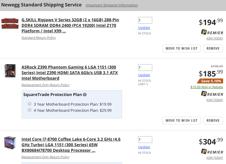

That's not a bad deal, but if you want to compare, the new E-2176 (And thus the i7-8700 it is based on) has about the same passmark score as that dual proc system...an internal GPU and if you are smart with the MB you can get the proc and MB for about the same cost.  Granted, the only real benefits of that are the iGPU and lower power consumption....with power being hugely lower, 2x130TDP vs 1x80.
That said, if power and iGPU aren't a concern for you having the extra PCI-E lanes and RAM slots would be nice....but only if you will use them.

The increased number of cores on the E5's be an advantage right?
I mean, I don't use a TON right now... but that's probably because I can't. There's a whole host of things I'd like to be doing on it but don't have the speed.
Also looks like that system is limited to 64G RAM?
I'm not a HW guru so ... sorry for the n00b questions
Edited by CowboyRedBeard

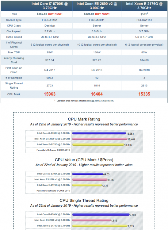

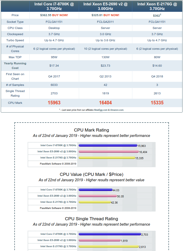

So maybe something like the following:
What's the difference / advantage of an i7 vs e5?

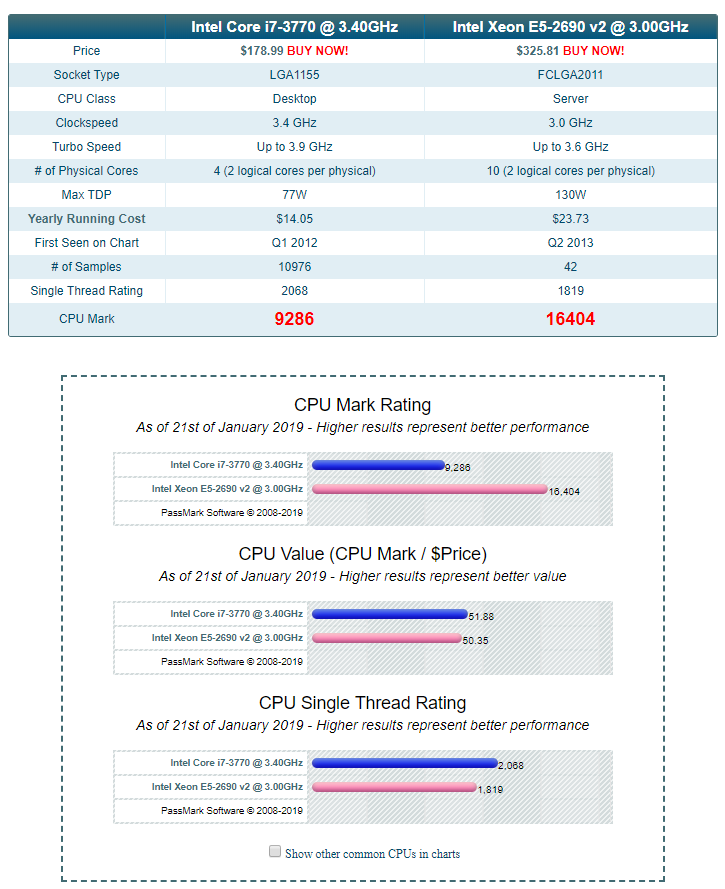

Well, if you stack them up... the i7-8700 / E-2176 are much faster per single thread process... but the number of cores is a factor. Plus, the below only shows it on a CPU v CPU basis. With the e5-2690v2 system from eBay I'd have 2 processors with that 16404 passmark and 40 threads total.
I mean, bang for buck (power consumption aside) the dual e5-2690v2 system would blow the others away right?
