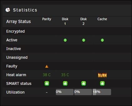

so today i installed Unraid on my machine and now i am in the process to move my media to unraid, server is located in my porch and is cool air there.
i noticed that my NVME cache drive is 66-C and is flashing hot, should i be worried, and if i set to spin down  cache drive that error disappear, if set to spin down will affect the NVME cache drive performance ?.  Is any way to fix this ?

That's normal for NVMe devices after large writes, though a cooler will make it better, they can usually go up to 70C, then it will start throttling, you can set custom thresholds by cling on it on the main page.
@johnnie.black thank you for information, i will change that NVME in the future with larger SSD HD, for now i think is fine
