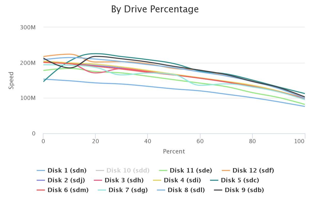

Could someone please take a look at my drive speeds, as you can see all my drives appear (in my opinion) normal for read and write except my brand new HUS726060AL5210 Helium filled SAS drive with an awful 46mb/s write speed! but it does have the fastest read of all my disks.
You can see it shares a controller with normal SATA drives on the same port so do I have a dodgy drive or a setup issue?
Judging By the results of the write speed of the Barracuda Pro (Disk 5) this is what I will use as my parity but maybe move it to it's own controller?
I started all this investigation due to replacing my parity drive with the HGS SAS Drive but getting approximately 20-30mb/s rebuild speed

Tests were carried out in Krusader using a KINGSTON_SV300S37A480G SSD connected to the
Intel® Z77 Serial ATA 6.0 Gb/s (On Board Controller) as the source & destination with no parity drive and using an 8GB Test File.
Here are the results
Disk 1 WDC_WD30EFRX-68EUZN0 (3TB)     140.7 mb/s (READ) 146.6 mb/s (WRITE)
Asmedia® Z77 Serial ATA 6.0 Gb/s (On Board Controller)
Disk 6 TOSHIBA_HDWD130 (3TB)               196.9 mb/s (READ) 192.2 mb/s (WRITE)
Disk 9 ST3000DM008-2DM166 (3TB)         213.9 mb/s (READ) 201.0 mb/s (WRITE)
LSI SAS2008 In PCI-e SLOT 1 Set to GEN2 X8
Disk 2 TOSHIBA_HDWD130 (3TB)                192.7 mb/s (READ) 188.1mb/s (WRITE)
Disk 3 TOSHIBA_HDWD130 (3TB)                193.1 mb/s (READ) 193.6mb/s (WRITE)
Disk 4 TOSHIBA_HDWD130 (3TB)                193.0 mb/s (READ) 184.0mb/s (WRITE)
Disk 5 ST6000DM004-2EH11C (6TB)           224.5 mb/s (READ) 235.4mb/s (WRITE)
Disk 7 TOSHIBA_HDWD130 (3TB)                196.9 mb/s (READ) 172.1mb/s (WRITE)
Disk 8 ST3000DM008-2DM166 (3TB)          199.2 mb/s (READ) 184.8mb/s (WRITE)
Disk 10 ST6000VN0033-2EE110 (6TB)         217.1 mb/s (READ) 222.8mb/s (WRITE)
Disk 11 ST6000DM003-2CY186 (6TB)          170.2 mb/s (READ) 204.4mb/s (WRITE)
Disk 12 HUS726060AL5210 (6TB)               227.9 mb/s (READ)  46.7mb/s (WRITE)
