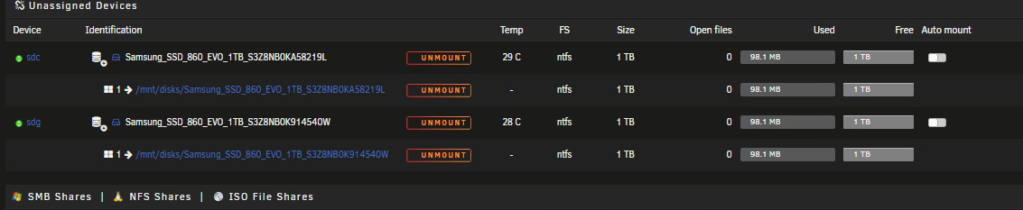

yes, I only mounted them to show the free space- they are showing in UD as unmounted.
When mounted- they show almost empty:
/dev/sdc1       932G   94M  932G   1% /mnt/disks/Samsung_SSD_860_EVO_1TB_S3Z8NB0KA58219L
/dev/sdg1       932G   94M  932G   1% /mnt/disks/Samsung_SSD_860_EVO_1TB_S3Z8NB0K914540W
but I am assuming that is because it isn't seeing the partition that exists with that .img file or something?!?!? this is maddening- it's like those drives are cursed ever since I removed them from the other 2 VMs... Can someone at unraid come to my rescue?  Nobody is chiming in from support?!?
