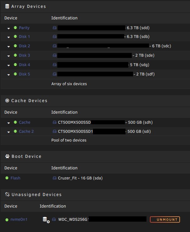

So I'm going to upgrade from my i7-3770 to a dual Xeon e5 setup. For this I bought 2 new (not refurb) 8TB Segate drives, initially I was planning on replacing the existig single parity drive I have which is a refurb that's a few years old with these two. Then adding that old parity drive to the array.
But, greed, and thinking about it.... Should I do dual parity drives, or just add the second one to the array to increase my storage? What's the common plan around this? I know everyone has different needs and uses. But is it more common than not to have dual parity drives?
Through what I've read, basically the only function of dual parity drives is to ensure you can fail 2 drives and not loose data. And that being, 1 array drive + the parity at the same time. Right? If so, how frequently does something like that actually happen?
Attached is what I have today... I use unraid mainly for Plex and a few VMs that are remote workstations.
What's your thoughts on dual parity? That's a lot of money for something that seems like winning the lottery of suckage. However, I'm only at 42% usage presently, and at my present rate of additional data per month it might be a few years before I hit capacity.
*Also, I keep the VMs on that M2 drive at the bottom.

The more disks you have the more justification there is for another parity. If you are careful (always check all connections when mucking about in the case) and diligent (setup Notifications to notify you immediately by email or other agent when there is a problem) then with only 5 data it probably makes more sense to add another data disk instead of another parity.
Another approach would be to replace one of your smaller disks with the new larger disk. That way you get more capacity without increasing the disk count.
Why cover the disk models? Was curious what model are the 6.3TB disks...
One more thing, the second parity drive is not just a copy of the first parity drive, it actually goes through another algorithm (that I believe is actually sort of cpu heavy) to calculate the second disk. This means you can lose any 2 drives, not just 1 data + 1 parity drive at once. It could be for example, 2 data drives dying, and you would be fine.
From the way you worded your question, just wanted to clear that up :)
Edit: I do agree with them though, for your number of disks I think just 1 parity is appropriate. I personally moved to 2 parities around the 12 disk mark I believe.
