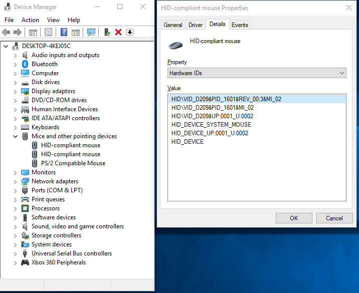

Windows does recognise and says it's ready to use.
i can also see it under the device tab but the gun fails to work.

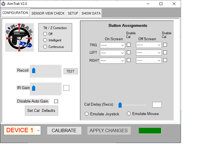

When i open the software the green box that usually shows the firmware version shows as blank. if i remove the gun from the usb port the box turns red so it kinda knows it's attached.

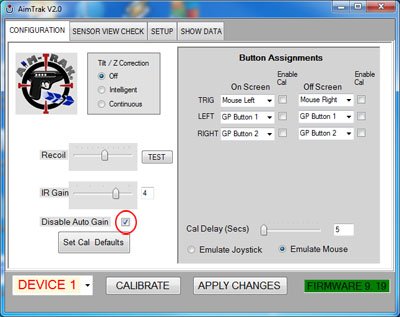

This is how it should look -
